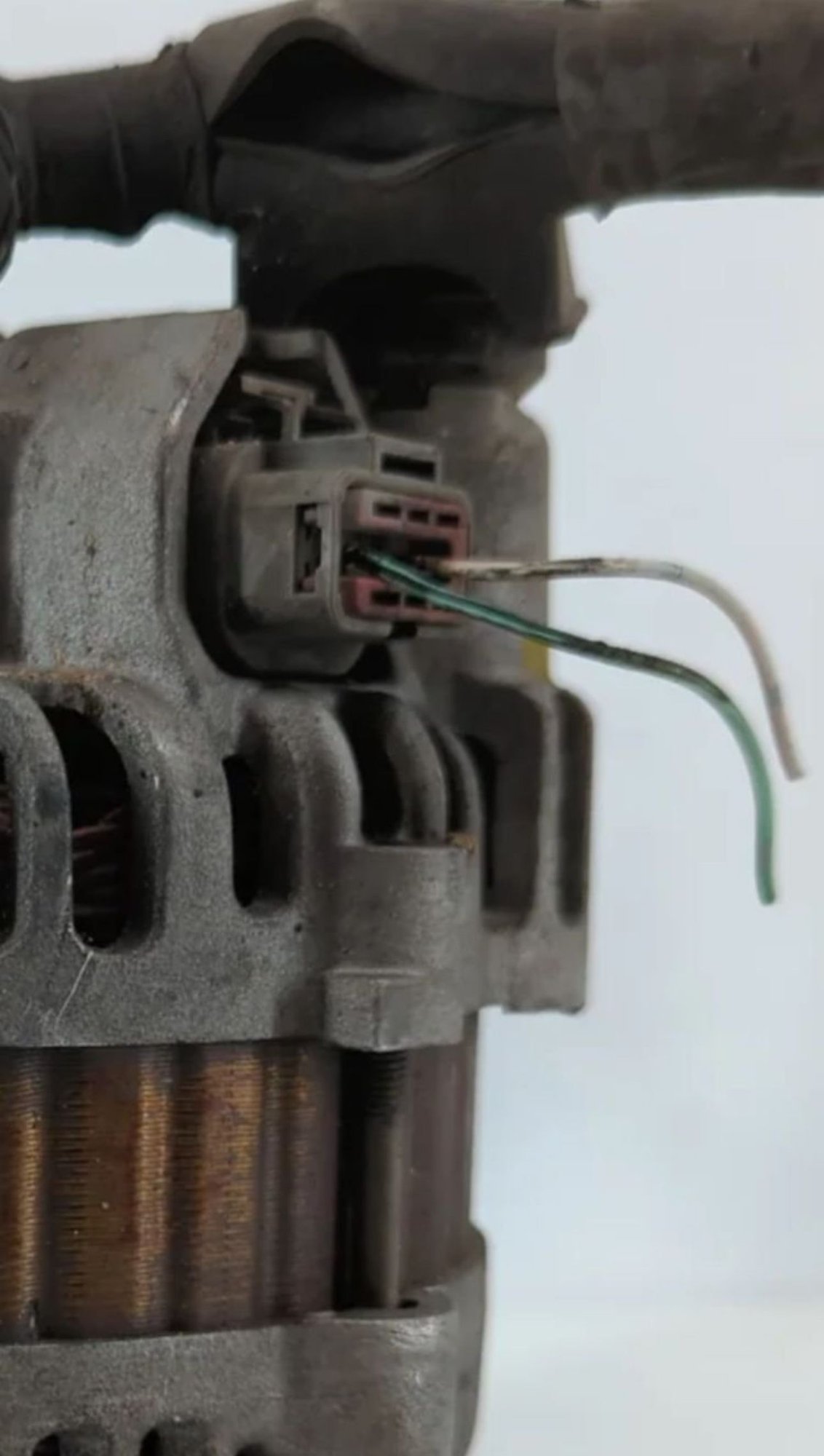

Welp, I was changing my alternator and thought i was clippin a zip tie, Turns out i clipped the alternator plug that has 2 wires. I ordered a new plug but am having trouble finding info on these wires. I figured i would take them out of the wire loom to solder or butt connect the new wires on. Of course im having issues with that even. SO if anyone could help me out. I need to know what color those wires are or atleast if someone could tell me where they go to so that worst case, if i cant successfully connect this new clip to the wires i cut, then i can just run a whole new wire from wherever they go. (Battery or ignition). Im not talking about the wire that goes on the post on the back but the wire connector that has two wires and is a grey clip. Or if anyone has a pic that would be most dope. Thanks in advance

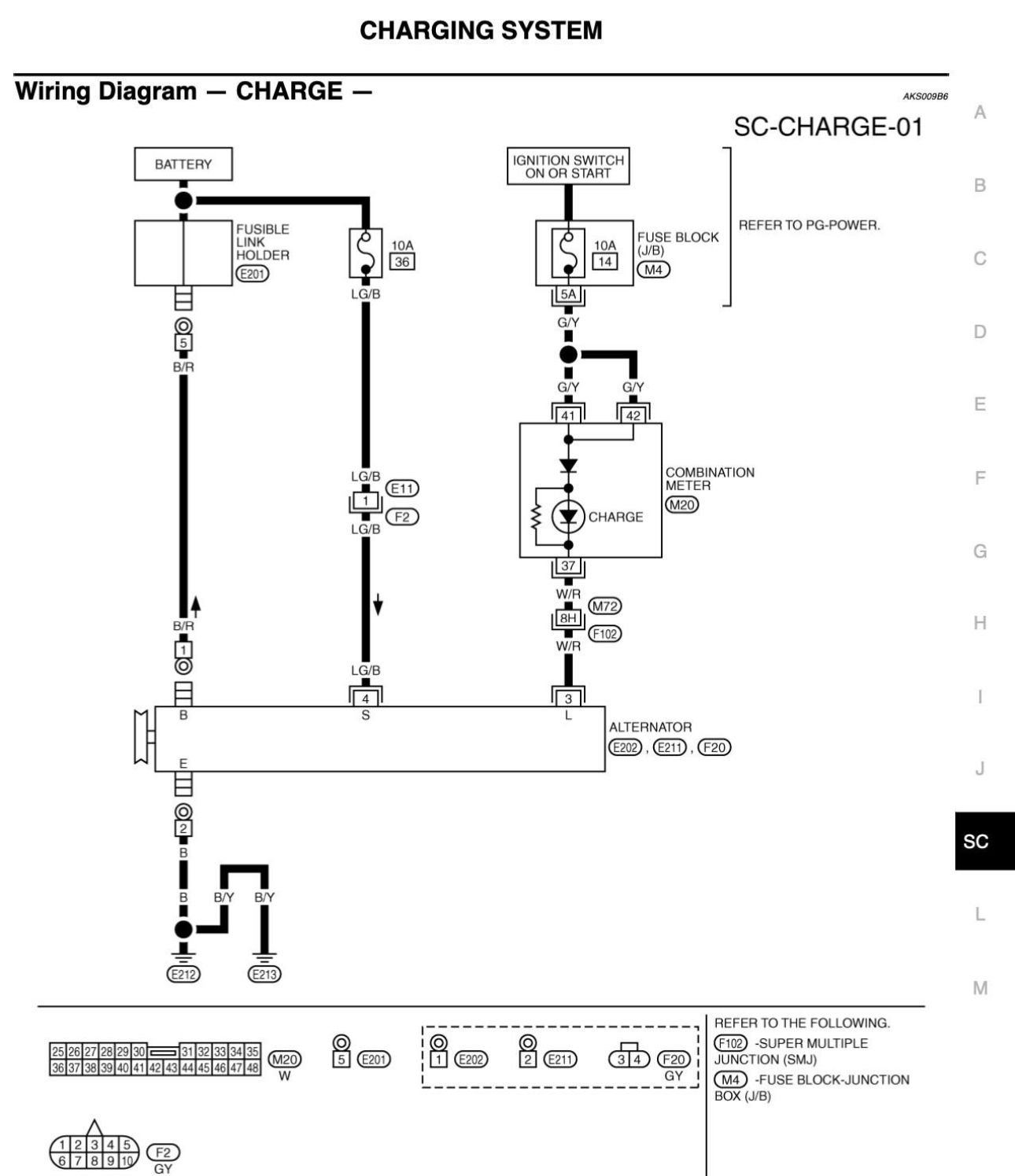

Factory service manual will have the wiring diagrams and the legend for the wire colors. https://www.nicoclub.com/infiniti-service-manuals

I did find some pics on another post finally. I couldn’t find anything when I was searching last night. Now I just need to figure out where these wires are physically routed in the engine bay. Here’s the photos incase anyone else needs them in the future.
