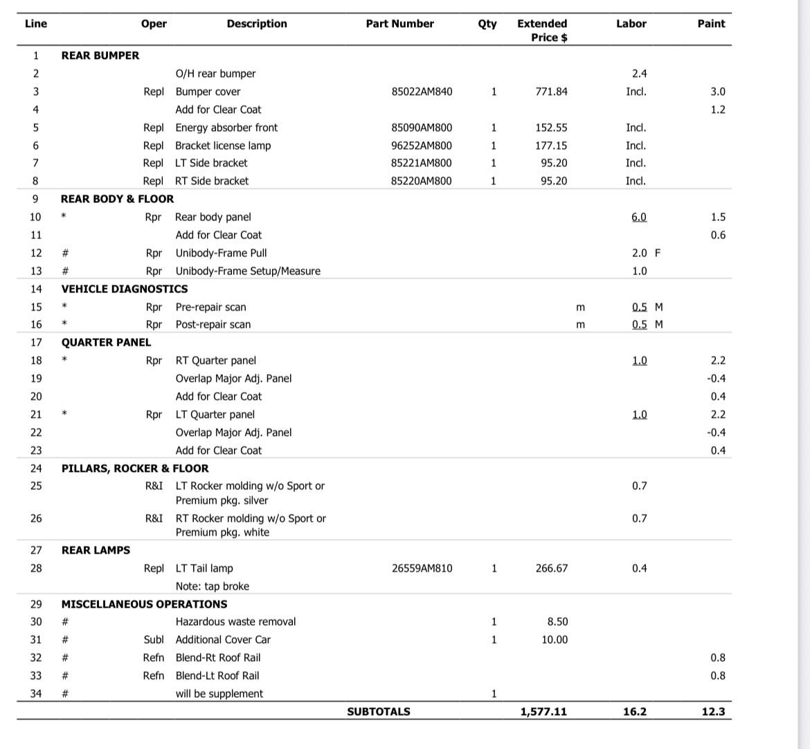

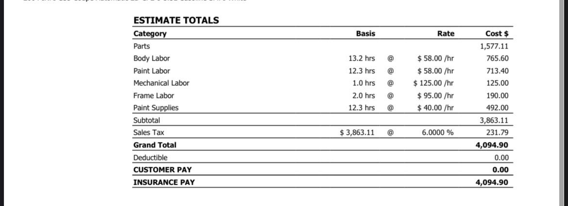

Rear ended while sitting in a drive-thru. Yea, that’s my luck. Their Insurance has claimed it a total loss due to repairs exceeding their perceived value. Estimate included.

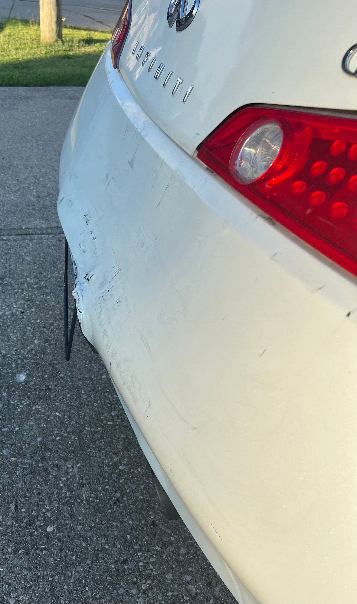

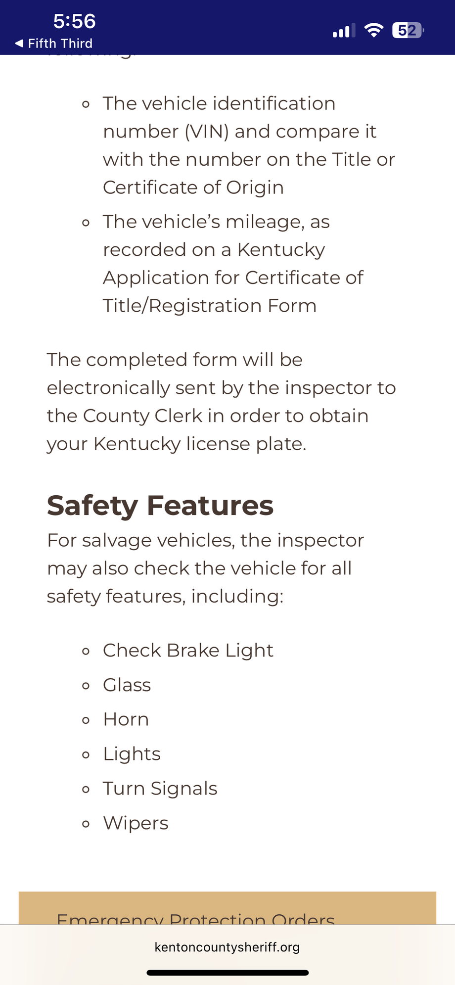

3. Salvage/Rebuilt process. I’ve attached the KY regulations on inspection. Seems like I already fit everything as is. Everything works as normal aside from my bumper dent. Any chance of bypassing straight from salvage to rebuilt? Or possibly just a slap a new bumper on and you’re good.

Why don't you visit a normal body shop and have them write you an estimate. Then take that estimate to the other guys insurance and skip yours because the way i see it, their insurance wants to cash you out and wipe their hands.. I see less than a grand in parts, paint and labor for this fix. Coupe rear bumpers are hard to find but if you do find one then the most expensive part is paint and you can swap it yourself. Bumper reinforcement beam can be bent, it's hidden behind the bumper cover.
I'm blown away how KY adjustors overwrite bunch of crap like frame work labor of 2 hours.. Body and Paint 12 hours of labor!!! WOW

I’ve found a white bumper at a salvage yard and plan on replacing the reinforcement, license plate bracket etc. Figure I can get all of that for $500. Then find a frame shop to fix what’s caused a slight gap on the trunk. Hopefully with that and paint to be at around $2k. Come out with $5k on my end.

I would definitely try to keep the car and fix it. It’s always hard to assess something with pictures, but it definitely looks fixable. If I was in the same situation that’s what I would do, especially since it looks like you’ll walk away with money after the deal is done and the car is fixed.
