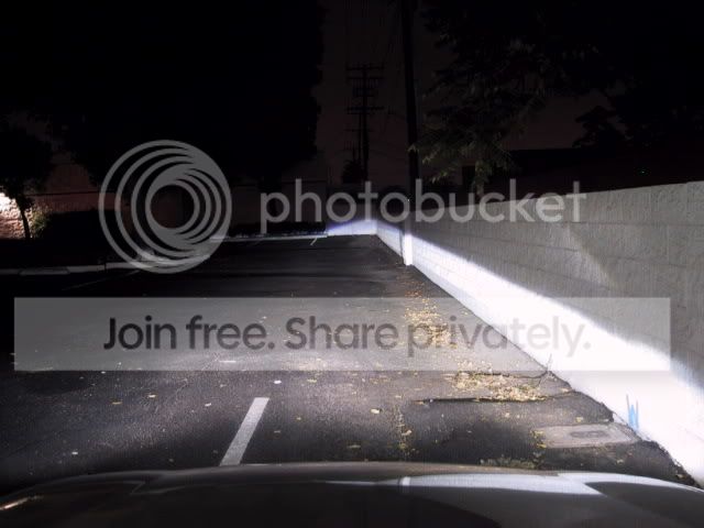

I just want cut off like this is that too much to ask damn so clean:
Old Oct 27, 2005 | 04:19 PM
  #43
djpj79's Avatar
Posts: 73
That MR2 mod has a NICE cutoff...
Any pix of the cutoff on the '06 headlights yet? I'm SO close to buying them, but i wanna see the cutoff sharpness first... we're waiting for your pix G6MT!

Anyone has pictures of the cutoff beam at night for the 06 headlights?

Originally Posted by mephistomyhero
Aww...but the only problem is, we will lose our Clearance Strips? Is that correct? I like our clearance strips! Of course, you guys do know that they can retrofit our cars to have projectors for about $1000 INCLUDING bulbs, right?
You mean like this?
