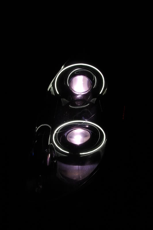

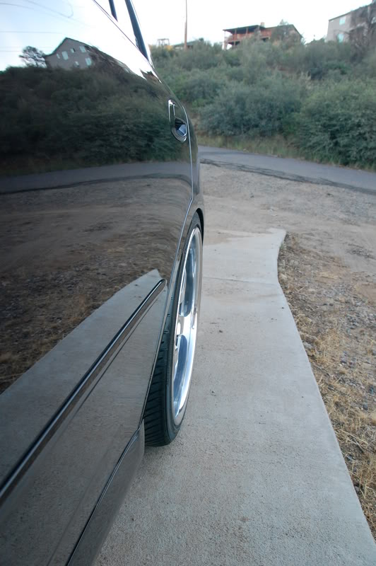

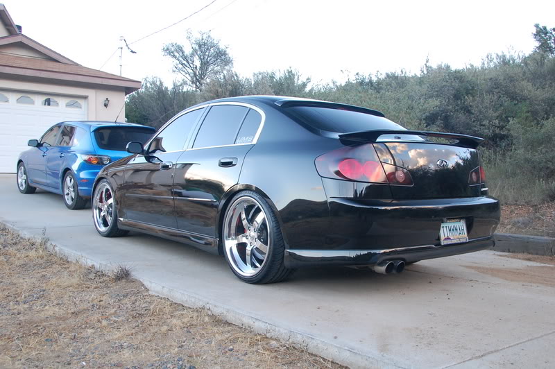

Smile
I posted these in another thread which is in the picture share section but I thought they would go well here too.
So after my detail I decided to take a few pics.
I know I look like a dork and my garage is a mess. I am getting ready to sell my house and packing so the garage is trashed.
Old Sep 25, 2007 | 06:15 PM
  #730
MIA BlazinVQ's Avatar
brb getting cut
Joined: Jul 2007
Posts: 4,255
From: Miami, FL
^^clean, clean, clean, clean, and did i say clean?
Old Sep 25, 2007 | 06:24 PM
  #731
ttrank's Avatar
Grocery getter
iTrader: (57)
Posts: 27,305
Likes: 190
From: Phoenix
LMAO at your sig.
Old Sep 25, 2007 | 07:59 PM
  #732
TIRE_SMOKE96's Avatar
Joined: Dec 2006
Posts: 1,529
From: Hawaii
holy cow! how did you get your G that mirror finish!
