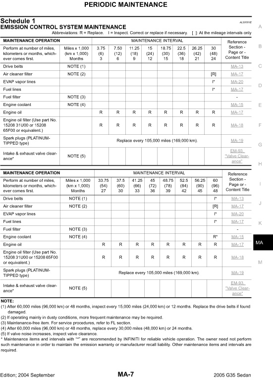

I've attached the maintenance schedule from the service manual (see attached)
From the above list it seems like you might really be lacking in maintenance. "Changed rear diff fluid at 60k" .. that fluid is supposed to be replaced at 30k.
