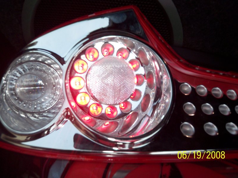

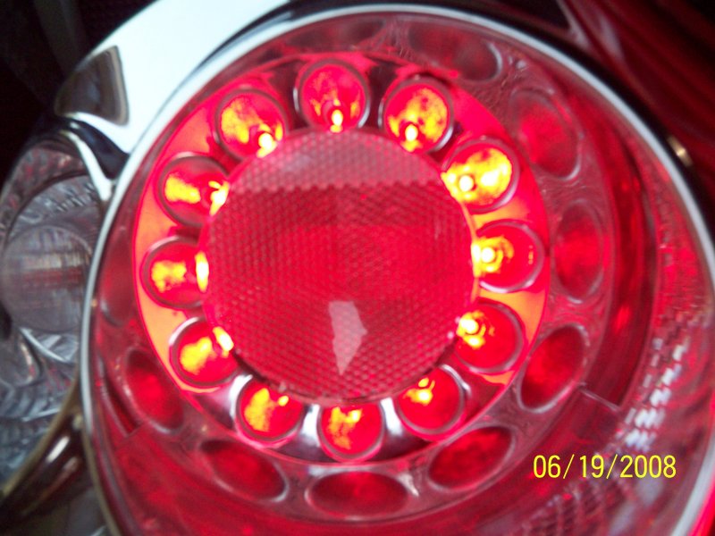

Factory LED's in the Taillight are White.
proven from a member here rugratcoupe, who disassembled them.
^^ not correct, LEDS are RED
Old Jun 19, 2008 | 11:03 AM
MidnightG35X's Avatar
Joined: Sep 2006
Posts: 588
From: Cedar Rapids Iowa
I have taken them apart many times myself... check the sequential mods in my signature. The lens/package on the LED is clear, but that does not mean the LED illuminates white.
Video of lights with no diffuser or lens
Originally Posted by racefan318
You might be correct, I just had to go verify for myself WHY...
From:
http://www.superbrightleds.com/carbulb-notes.htm
For best results the LED color should be the same as the lens color. As an example: a red lens will filter out all but the red portion of the light so if the light is all red, none or very little light will be blocked by the lens. The light from a White LED contains very little light in the red portion of the visible spectrum so most of the light would be filtered out by a red lens
This is very true. LED's are monochromatic (outputs a narrow wavelength of light) as opposed to an incandescent which spews light all across the spectrum. You can use a color lens behind an incandescent and still get something. With an LED, you will get much less output behind a different colored lens.
Old Jun 19, 2008 | 01:28 PM
RST531's Avatar
iTrader: (27)
Joined: Dec 2004
Posts: 1,646
From: So.Cal (626)
my ref is from another member who does geat one-off mods, so he said it was white, i personally did not. also he was ref. to coupe taillights. actually i do have an open set of coupe taillights, ill try to plug them in this weekend to verify the color with pixs.
Old Jun 19, 2008 | 01:50 PM
Joined: Sep 2006
Posts: 588
I have done coupe tail lights also. They light up red. I'd post the pic, but photobucket seems down (as can be seen if you look at the coupe sequential thread in my sig). I do not want to sound condescending, I just want the correct information to be out there.
Old Jun 19, 2008 | 11:07 PM
RST531's Avatar
iTrader: (27)
Joined: Dec 2004
Posts: 1,646
From: So.Cal (626)
^^ agreed. but i comfirmed that led are red. i had a set apart for 2 months now and never lit them, until today. pixs attached.
Attached Thumbnails Taillight LED's Not Coming On-100_2347.jpg   Taillight LED's Not Coming On-100_2344.jpg
