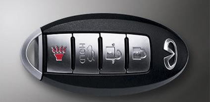

I have one intelligent that came with my 2005 infiniti and i just purchased another one from ebay. How do I program it? Is this the right instructions for the intelligent key (http://www.infinitihelp.com/diy/comm...am_key_fob.htm?

you have to take it in to the dealership. they usually want both fobs together. i believe the instructions you have are for a standard fob.

First, did your car originally come with one? Does your car have push button ignition? If so, you can have up to 4 I-keys programmed to your car. The dealer will need all I-keys and your car at the same time to do it.

Thanks for the info. The seller name is mag7437. Car came with the I-key. Just bought an extra one just in case I lose one.
How much does the dealership charge to program the I-key?

I've been quoted $50 for the programming from my local Nissan dealer.

yeah, anywhere between $50 and $100.^

I just got it done earlier today for $45.

this i-key you purchased off ebay, does it include the actual key that goes inside the I-key? And if so, was it blank, meaning it just needed to be cut? I have seen some i-keys on ebay but some of them are used, which most likely means the actual key is cut for another car. Thanks.

all keys must be together for programming.

It was a used i-key and the mechanical key that came with it was already cut.

What do you mean by all the keys must be together? So its not possible to program the i-key without the mechanical key? Does the mechanical have to match?
