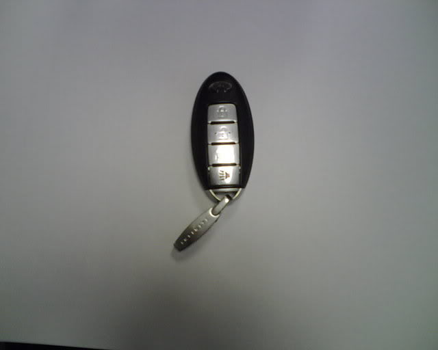

stupid question but are you sure you picked up an Intellikey from ebay and not just the keyless entry fob? The solid red I-key dash light means no Ikey could be detected.
Does it look like this:

No, it is the correct key, it just isn't working.
I guess it can't detect the key properly. Thanks
