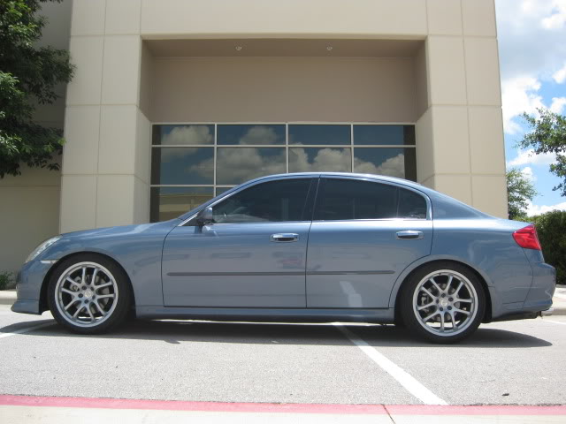

K. By any chance anyone has pictures for 03/04 sedan with H-tech, S-tech or Eibach Sportline spings? Hopefully with the OEM stock coupe's 19's? I know for the eibach it's 1 1/2 drop or so. Which I think is not enough drop for me. how much drop for the H-tech or S-tech? anyone know? (I don't have a budget for coils for now so springs it is! )

05 sedan, coupe 19s, sedan S techs, z struts
But my advice is to save the money you have for springs and keep saving until you have enough to get some coils. You will be waaaay happier in the long run I promise.
I'll still try to "save" if I can for the next 2 months. I have 2 questions though: will s-techs give the lowest possible drop with those 3 choices? And, are z struts have the same height as my stock 04 sedan struts?
No, they're shorter, which is what you want when you're lowering the car.
