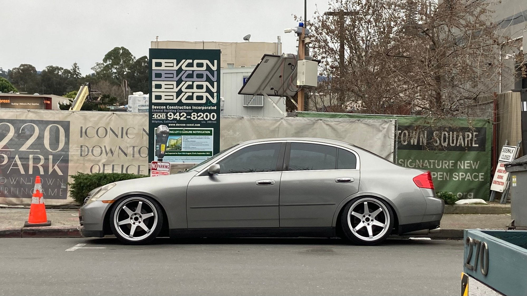

BC racing extreme low coilovers w/ 12k front 10k rear spring rates. Godspeed upper camber arms and energy suspension inner lca bushings. Megan racing front strut tower bar.
Edited to add: Completed the rest of the front suspension lca/compression rod bushings with energy suspension, new outer tie rod ends and a rear Megan racing sway bar.
