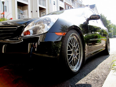

I've got 285/35/19 on the rear of my sedan.

I'm running BC coilovers, rear wheels are Linea Corse Lemans 19x10 +43, 285/35/19 tire.
My fender lips are shaved.
