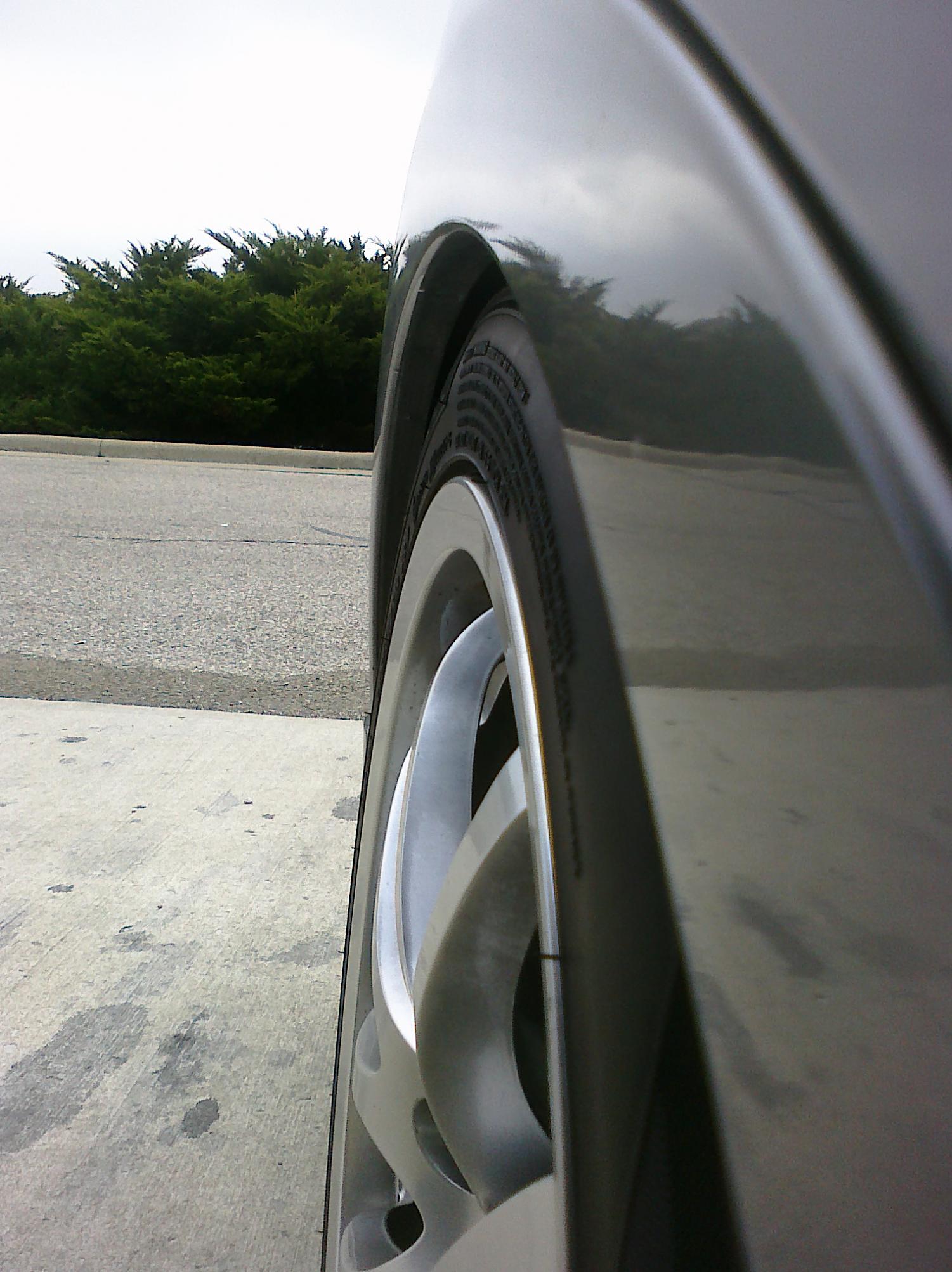

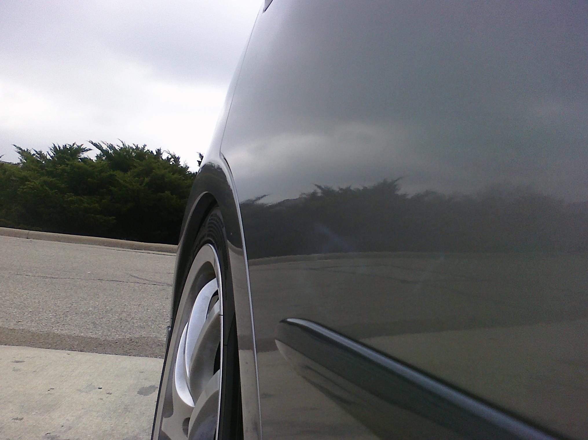

Im going to roll the fenders, and was wondering how many mm spacer will i need to sit flush. 19 x 8.5 33mm offset on 245/40/19. thanks
Attached Thumbnails How big of a spacer do i need?-cimg0078.jpg   How big of a spacer do i need?-cimg0079.jpg

Assuming you don't change your camber, i doubt you'll get more than 5mm. 10mm spacer will be close.

yup 5mm should suffice

your fenders look like they're rolled. at least 10mm. 5 will not a noticeable difference

Here is an idea of what 10mm spacers in the rear looks like on Coupe 19s and 245/40 tires. My camber in these pics was ~1.4 or so IIRC. Fenders rolled very flat.
10mm spacers - rear

For the fronts, if you are running 245/40 you'll only be able to run a 5mm, with a 10mm I rubbed like crazy.
