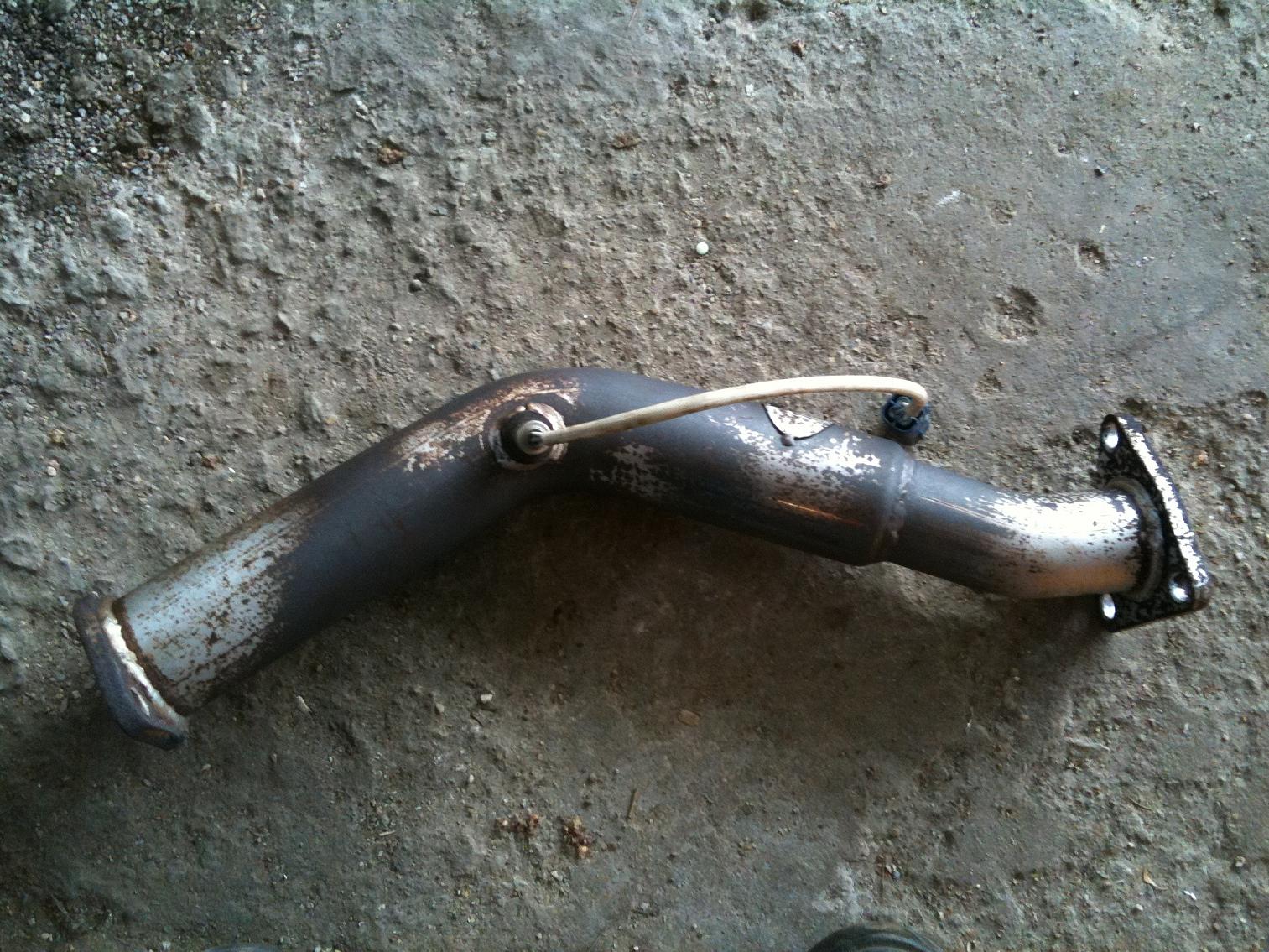

What kind of driving are u doing Dofu? I drag race weekly with stillen test pipes for over two years with no cracks or problems.
As far as the rasp goes, I replaced my cats with stillen test pipes the rest was stock. The raspy sound started from the stock muffler, it wasn't designed to handle the higher flow and temperatures. Within three months the internal baffles blew apart in the stock muffler causing a crazy loud vibration. I cut it out and welded in a flowmaster. With the flowmaster the rasp was reduced considerably. I spoke to an engine builder from P&L tuning, he said the 2003 engine only has variable exhaust valves and the newer motors have variable intake and exhaust. He told me the ecu would make slight adjustment on it's own and that might eliminate some of the rasp, he was right. After a driving it for a couple weeks it toned down alot but was still there around 3500 rpm.
Now last week I installed headers and a stillen dual exhaust. When I fired it up it sounded terrible so I started investigating. What I had found was the stillen exhaust system used the factory gaskets between the test pipes and the cat back system. The factory gasket is a two layer piece of stainless that has the potential to vibrate if it's not perfectly aligned. F that ish, I ordered new solid one piece gaskets and the sound is 100% better.

Check it out, the first video is stock system with stillen test pipes and no muffler
And the next is with a flowmaster muffler, huge difference in the rasp
Here's a pic of my race pipes after 10,000 miles, two winters and two summers of drag racing. All in all a little surface rust ain't bad.
