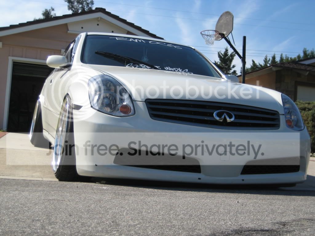

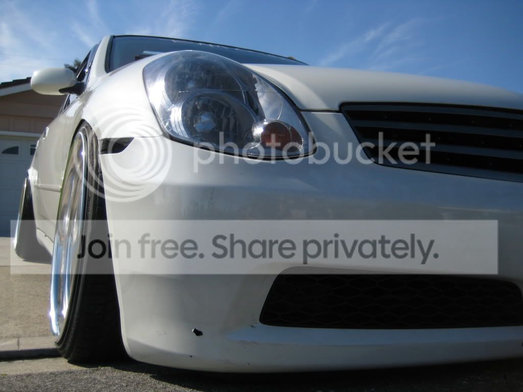

I think a 225/35 look good on a 9.5, that's what i got on my front..here's some pics...

thanks yea i think that 225/35 would look good in my rears .. just by looking at the way the tire is i should have some room to put + camber and make the wheel poke out... would that size hold up good on my rear as a DD ???
what do you think i should do with a 19x8.5 for the front ??
Old Apr 16, 2010 | 11:18 AM
  #40
The Stimulation's Avatar
iTrader: (69)
Posts: 10,850
Likes: 158
From: Los Angeles
Yeah it'll be fine. That stretch is very common. Keep in mind that the brand of the tire makes a difference. I have Hankooks. Those run true. If you go with say a General, it will have less of a stretch.
