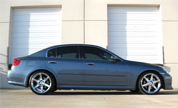

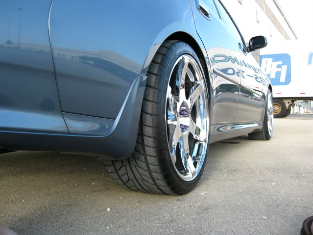

Blue Dream's Avatar
I drove ttrank's car solo
iTrader: (50)
Posts: 18,299
Likes: 1,488
From: By the sea, Tx
When I first bought my wheels. Tires are 235/35F and 275/30R on a 9.5" rim +38. Amazingly I was also dropped on S Techs at the time and you can see there is plenty of room between the top of the tire and the fender. Just a word of caution though, the ride was terrible.....much worse than the 245/40 I had on all 4 corners previously.
Old Feb 17, 2011 | 04:51 PM
03GT35R's Avatar
Joined: Aug 2006
Posts: 299
im currently running the stock 17" 5 spoke sport rims w/ 235/45/17 the ride is ok but not a smooth one for sure...Thanks for the pic & info...pretty much same set up i m looking for...do you have a close up pic on the front?
