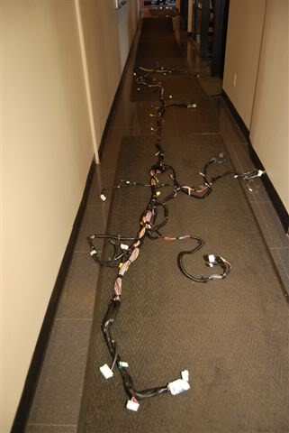

My 2006 G35 has been at the dealer for a week now for a Air Bag flashing light. It has 137k miles on it & is out of warranty.
The drivers side air bag module and sensors have been replaced on previous visits for the same problem going back to 2007 when I was still under warranty.They are going to replace a wiring harness that involves removing the entire dashboard.

The wiring harness came in and was replaced.
I got my car back last Thursday.
So far, so good. No more flashing air bag light.

The flashing air bag light problem was a 5 time repeat problem over a 4 year period. In addition to the connector, the air bag module and a sensor have been previously replaced. After the 1134 code kept repeating the flow chart called for replacing the entire wiring harness. So far after 1000 miles, no more flashing air bag light.
