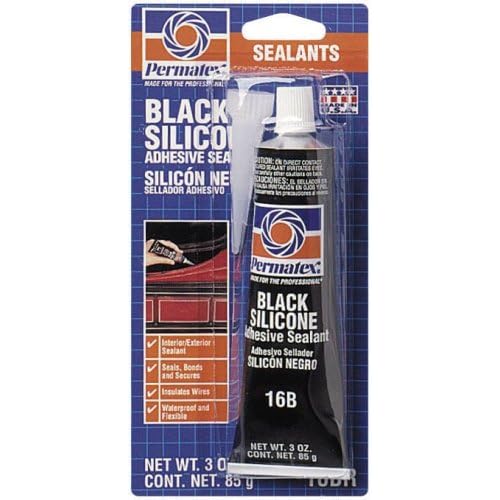

what did you used to seal the headlights back? like what type and brand? silicone i guess right
I used this stuff
