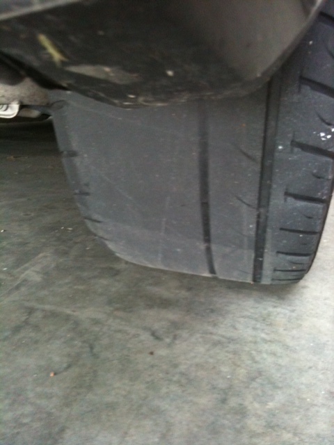

This is the wear on my tires that i just replaced (I know, i drove these to the absolute limit) Is that Toe or Camber causing that type of wear?
