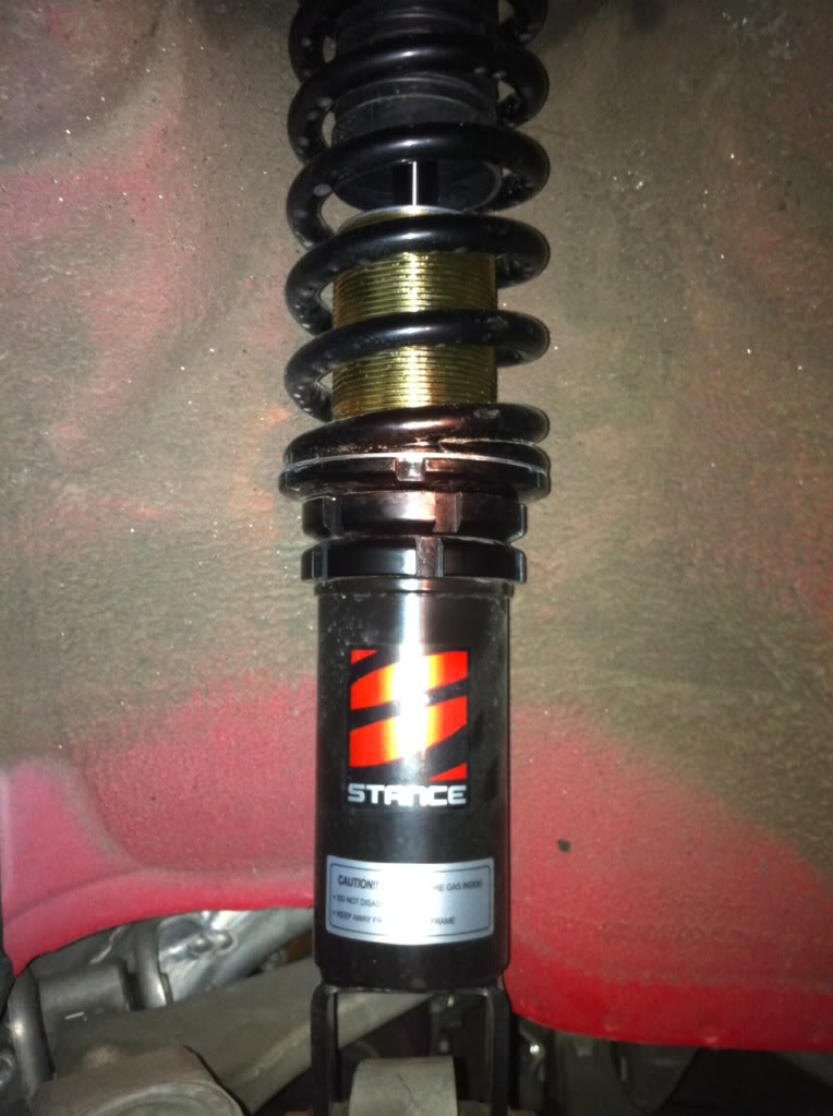

okay, couple things here:
by max out, you mean B and C collars are now touching each other or that the shock cartridges can't go any lower and there's spaces between B and C like the picture shown?
if it's the later, what you would need is shorter cartridges.
DO NOT remove B collar as it's the locking piece.
If it's the first scenario, then you can get shorter springs.

Here is a pic of a maxed out stance coil.
