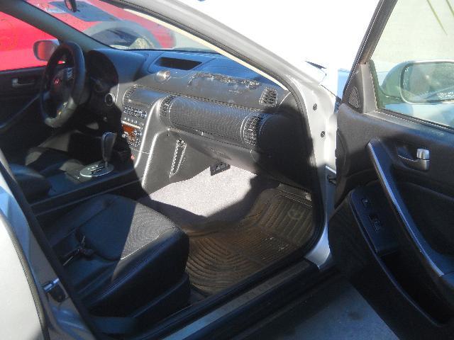

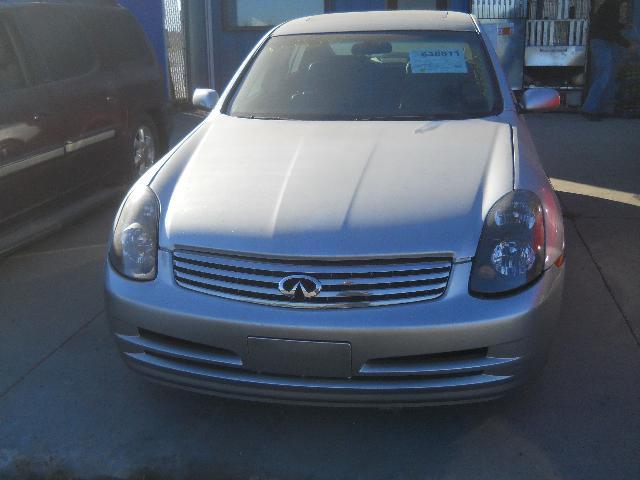

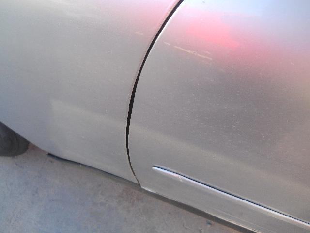

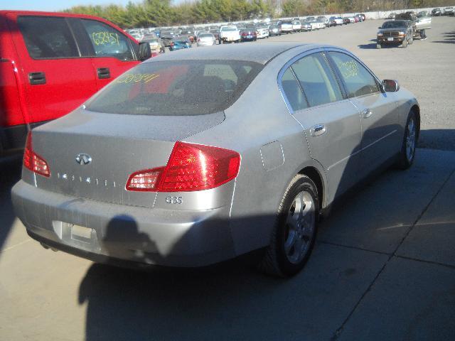

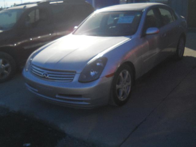

Here are the pictures the way I bought it

...and I thought my bumper, hood, and fender gaps were bad...
I don't really know how to adjust those pieces. OEM parts? Maybe that's as good as aftermarket pieces will fit?

It looks like they replaced it with cheap aftermarket parts. Time for a coupe front end swap.
