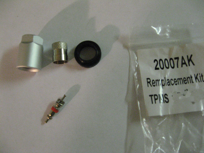

The kit includes 4 parts usually and every time a tpms is removed or "serviced" the kit needs to be used to replace parts of the sensor.
As noted above, the battery is not replaceable and is the main reason a new sensor has to be bought.
