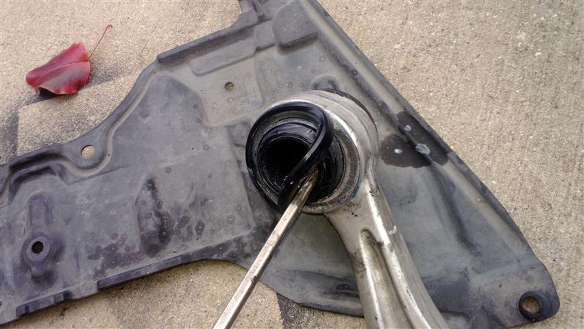

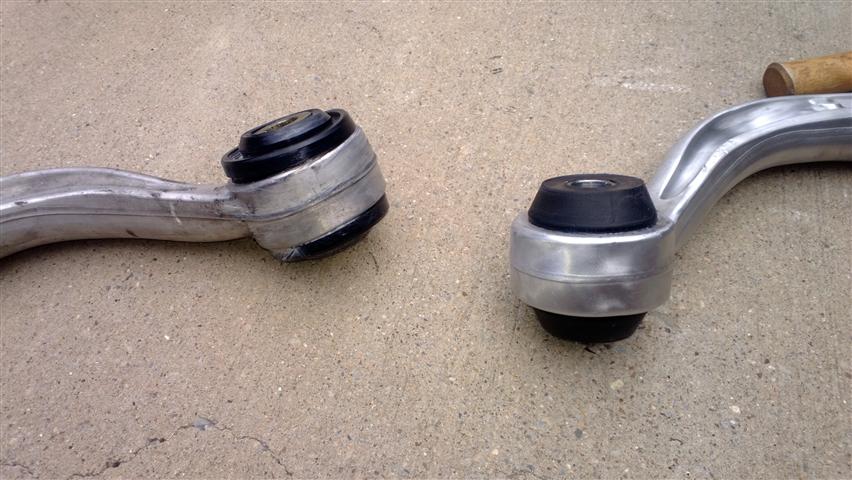

My whiteline bushings started to squeak. It sounded like a flap/squeak. I pulled them off this past weekend and there was a small tear in it (not sure if it affects performances. I installed the Armstrong bushing and used prothane grease.
Flapping went away but still was squeaking. Replaced my swaybar bushings on Sunday and squeak is now gone. Front suspension is all tidy now. Need to work on the rear this weekend.
Honestly, I think the prothane grease (19-1751) helps a lot in getting rid of the noises.
The SPL was a little too stiff for me, but it gave me the best performance on the corners. The Energy Suspension ones got noisy after a while, but can be helped with grease. Whitelines tore atfer 6 months, but it probably doesn't affect performance. The Armstrong bushings are nice in that they are one piece and the ends don't seem to separate from the rod itself under load (it drove me crazy on the energy suspension bushings, since water could get in there between the bushing and the metal.
Well see how they are after a few months of driving. If these don't last, I may go back to OEM.
