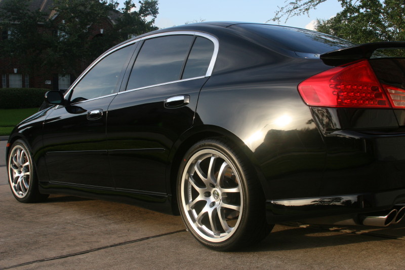

Z springs front (1"drop)/ gcoupe springs in the rear (1/2"drop). Gives a near even drop. On stock sport shocks/struts. Ride is decent too. (314/342 spring rate...same as my stock spring rate...mates well with stock shocks/struts.)
https://g35driver.com/forums/brakes-...reference.html
