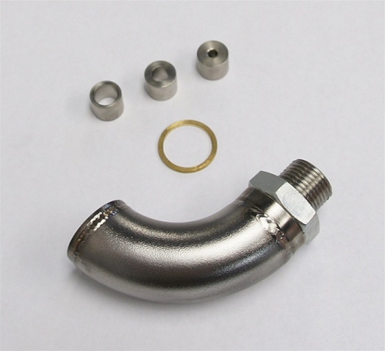

As the OP keenly found out, this is not actualy accurate. A little clarification:
Extenders are "NON FOULERS". Correct, these move the O2 sensor out of the direct exhaust stream so the sensors see less exhaust flow. This WILL NOT FIX YOUR PROBLEM. These are for the secondary/Post Cat O2 sensors, for when you remove your cats. You will probably need something like this because you DID remove your cats with Long tube headers.

What you need:
-2 Wideband O2 sensors. These must match the next item (not all are compatible with one-another)
-Engine Management (Piggyback, Standalone, lots of choices here)
-Non-Foulers for your seconday O2 Sensors, something like this is best:
-If you chose a cheaper Engine management, this is where you'll use O2 Simulators. This just basically keeps your Engine lights off. You actually control the fuel yourself with the Engine management device.

These are the o2 sensor extenders that i purchased and will be here in a couple days. I plan to install to get the bank 2 lean code from throwing the CEL light.
http://www.ebay.com/itm/261064763128...84.m1439.l2649
Those are great for getting rid of a Cat deficiency code. Like I said, non-foulers/extenders are made to fix codes you get after removing your Cats. The Lean code is different. This code is because the Air/Fuel ratio being read in your exhaust is out of the sensors readable range, in the lean direction.

I installed the o2 extenders into the secondary o2 sensor locations on the collector of the long tubes. I cleared the codes, reset the ecu and drove the car about 35 miles and the car is actually running a lot better than before. It has a better idle, and is not hesitating at steady speed or under acceleration like it was before installing these. I plan to run the re-learn idle with the scanner in the morning.
