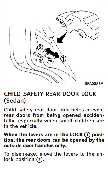

Wait! Before you tear it apart have you checked these?

Probably just the child lock.
