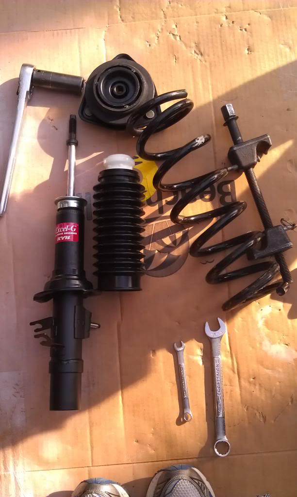

For piece of mind, I'd replace the struts, especially if it's a daily driver that you plan to push hard at some track events. Even better, get a set of boots and new strut tops also, then you can build a complete setup and R&R quickly. You'll only need to swap the lower mount from the old strut to the new. I did the same last summer on my '06x, and am happy with it- new KYBs up front with coupe springs.
R/R? can you explain? And the boots are the plasic sleeve that goes over the strut? Where did you purchase your parts?

R&R is remove and replace. You can build your strut assy. off the car with the coup springs and new struts/mounts. Then just remove the old assy. and install the new without having to break down the old spring/strut assy.

As mentioned, R&R = Remove and Replace. Yes, the boots are the sleeve that goes over the strut, and the triangle-shaped piece is the strut top. There's 3 nuts that hold it in place from the engine bay side. I ordered the struts and tops from Rock Auto, and then sourced the boots from my local auto parts guy cause they had them in stock.
