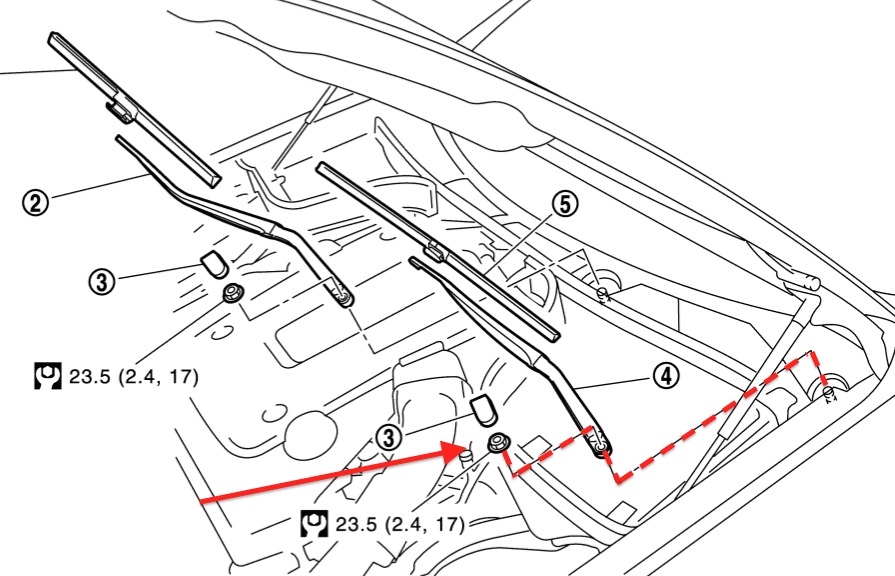

Here's a pic. Pull up the cap (marked 3) and make sure the nut holding on the wiper arm (4) is tight, Both wipers work off the same motor so if the passenger side is working then the motor is OK. Could be the mechanical linkage but more likely just a loose arm.

Ok I realized they are crossing because the driver side is not moving but the passenger moves just fine so I'm going to grab a small tool kit and remove the arm and see if its the plastic thingy in it is worn? Anything else I should be checking??? And thank u

Ok so pulled it off and the grooves on the actual arm where the bolt goes inbetween is stripped to the point where it's almost smooth. I retightened it and it seemed to work but soon as it rained and it was time to really work, it slipped again..,,,
So my question is how do I fix this do I need a whole arm or can I just buy something to give me groves?? If so part number please..thanks

That's exactly what it was do you know. Way to fix ?

Hate to say if but you might need dealer help on this one. Just looked quick (not a deep search) and can't find the exact part you'd need from the places I usually buy... I would consider this "safety related" so it's important to get it fixed and the dealer should be able to do it.
Get a new wiper arm

If I were you I would take the passenger side wiper off and put the working parts on the driver side til you get it fixed. That way you'll still be able to use the driver side without interference if you need to.

I can't the problem is the threads on the arm are stripped and I think the pass blade is longer and wired differently.
I saw a post with plastic inserts that the bolt goes thru to recreate the grooves but can't refine the post. The pieces were only $13 smh
