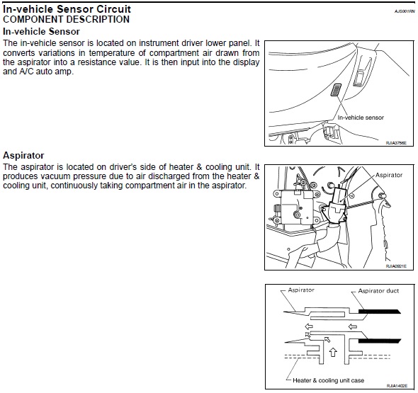

I was looking to make sure the wire for the a/c and heat was still connected being I tore apart my dash and thought I disconnected it.

its on the right side of the panel just above the driver's knees.
