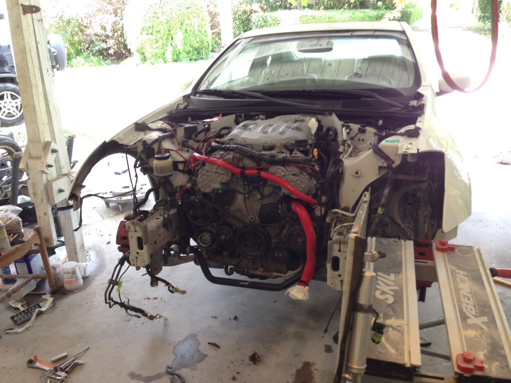

Yeah, I got skills beyond a/v, but when there's more experienced and qualified people to give advice, I sit back. Since I had some to contribute here, I did so.
When my engine went, I wanted to do the "remove-the-front-end" method of removing the engine/trans like these guys: Name:  IMG_3336.jpg

But, since I was renting, I didn't have the space to secure the dismantled car, and had to instead pay an asston (about $2500) to have somebody do what I would have preferred doing. Since I had to do drop the trans to put a new clutch/flexplate afterward (dual-mass didn't survive being swapped very well), I felt like I'd done half the work of the full engine swap already, - but that was a few-hours-job I was able to do on a day off at a rent-a-bay place.
Um, anyway, staying on topic, you've got virtually nothing to lose by just putting water in and trying to turn it over. Labor costs more than the engine, even after the core deposit and shipping.
