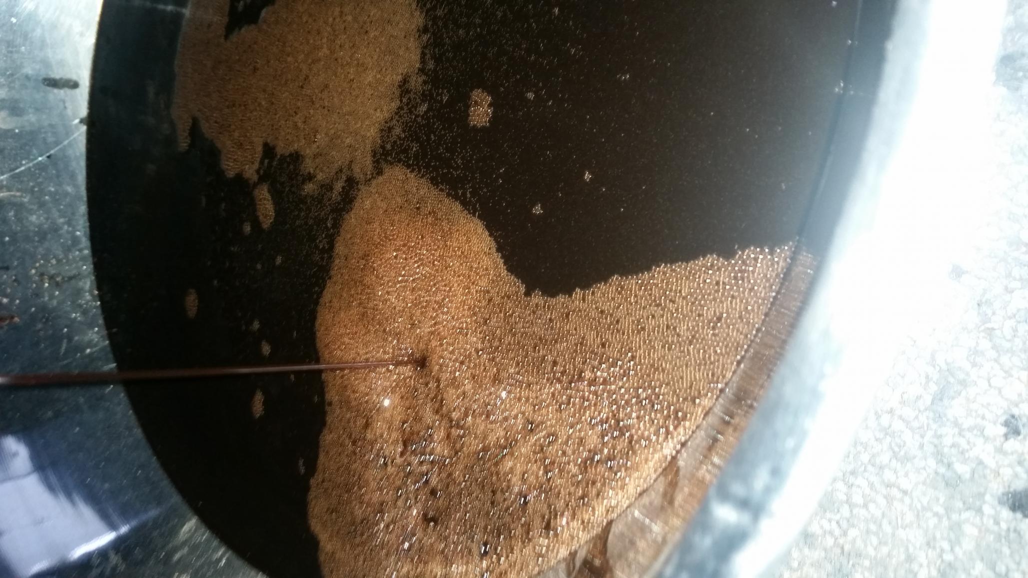

Old Jan 30, 2015 | 09:27 PM
arthurarenas's Avatar
Joined: Jan 2015
Posts: 32
