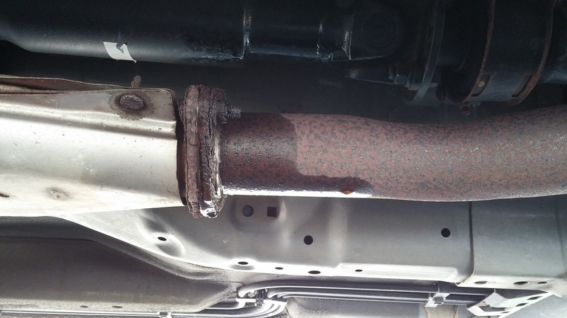

Well, I finally got my exhaust done this past weekend (about 2 weeks later than scheduled LOL). First off - the rust was much worse than I expected. I PB Blasted these nuts every night for a week after getting home from work, and you can see why -
In the end, one of them actually came loose with the breaker bar, and the other one rounded off, so I didn't have a choice. I used my cutoff wheel to slice the hangers, then the Sawzall to cut the mid-pipe and I removed the exhaust in one giant rusty chunk. I used wire hangers tied around the Y-pipe to support it, then we cruised over to the local Midas and had the studs torched off.

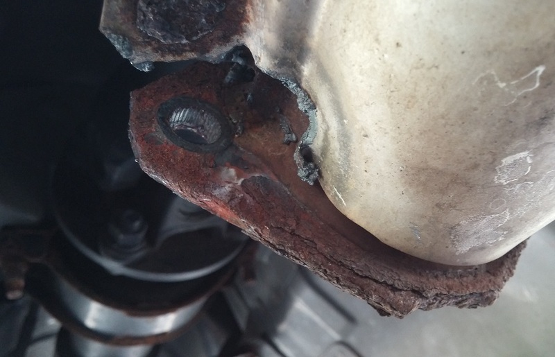

FYI, it turns out the studs going from the Y-pipe to mid-pipe are splined. You can see in this pic here -
I'll do a writeup another day with the rest of the pics I took for the DIYers out there on how to swap an exhaust in your driveway. It's totally doable!
