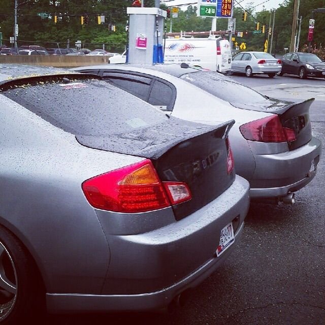

145k and a buddy of mine just ordered one with a 30 day warranty and he's gonna install it. yes too bad sigh*
his is on the left with jdm tails and mine of course to the right
