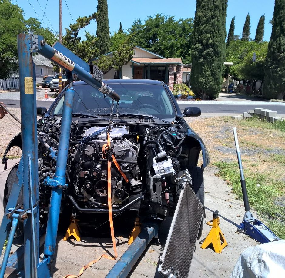

Hello All,
Just completed a swap of engines in my 2004 G35 6MT Sedan. The original engine had a bad gouge in the cylinder wall that was leaking oil into the combustion chamber and fouling the spark plug (compression was still fabulous at 185 lbs!), also ruined the driver's side catalytic convertor.
Went online and located several engines - chose one with a claimed 59,000 miles on it from a wrecking yard in Pennsylvania, had it drop shipped to my house, and we (my brother and I) swapped the engines in my driveway. Replacement engine looked like crap on the outside compared to my never-seen-snow California engine (had lots of corrosion and oxidation, being a "back East - snow belt" engine that had seen it's share of road salt and bad weather), but the inside looked great so we cleaned up the exterior with WD-40 and a wire wheel on a drill, swapped most of the exterior bits and pieces, installed the engine and we were good to go. Replaced the driver's side Cat with one I acquired used from a fellow G35 Driver, took it in for a smog check and we are officially good to go!
Replaced this engine in my suburban driveway with hand tools and a winch, and despite the directions given by the factory we didn't even evacuate the A/C system, just kept everything hooked up and charged and worked around it until it was all back together!
Another G35 adventure - how many of you have pulled your engines?
Thanks, DB

Here's a couple of pics...

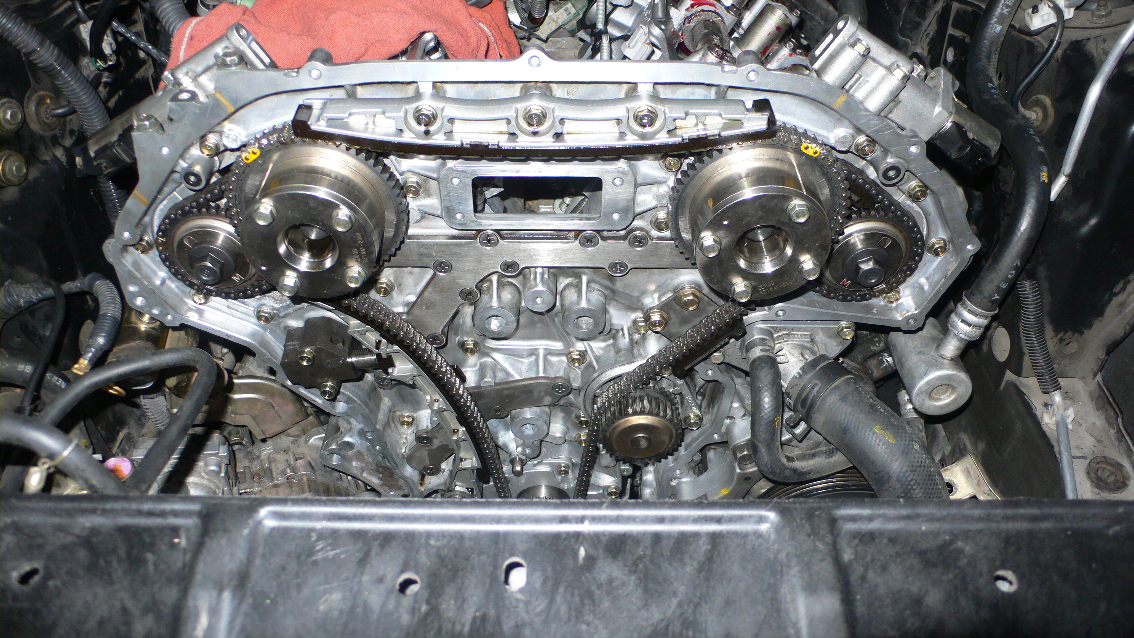

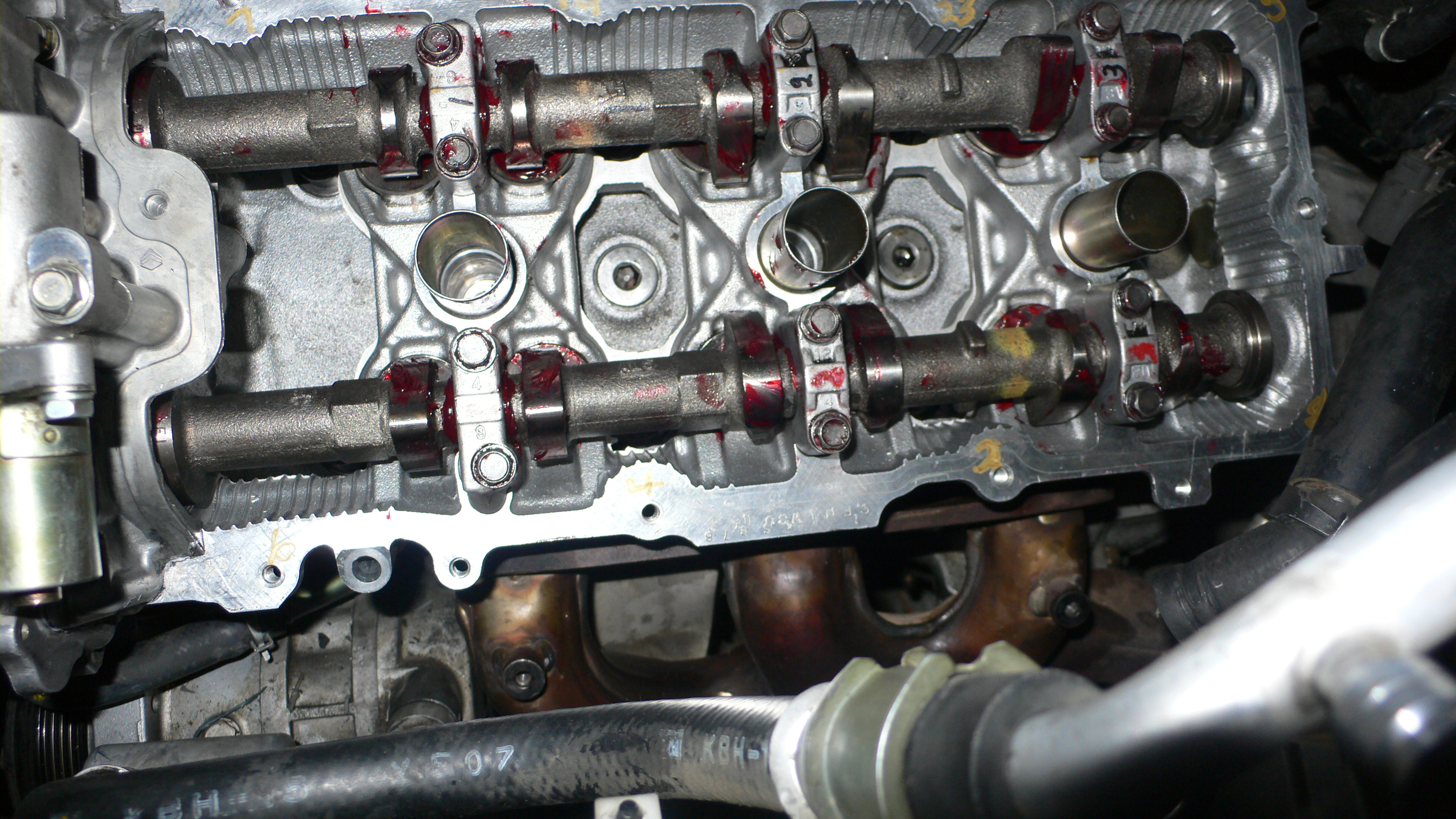

It's even scarier when you tear down the engine itself - with 4 cams and 10 timing marks to line up, it's a recipe for disaster if you don't get it back together just right. We tore down my original engine last year and had the heads redone when the car inexplicably "ate" a valve, and when we were reassembling it we saw the gouge in the cylinder wall that we knew could be trouble. Engine ran strong - like a scawlded dog - but it smoked a little and I knew then it's days were numbered. Got another 15,000 miles out of it before she git so bad I had to replace it with this other engine last week.
