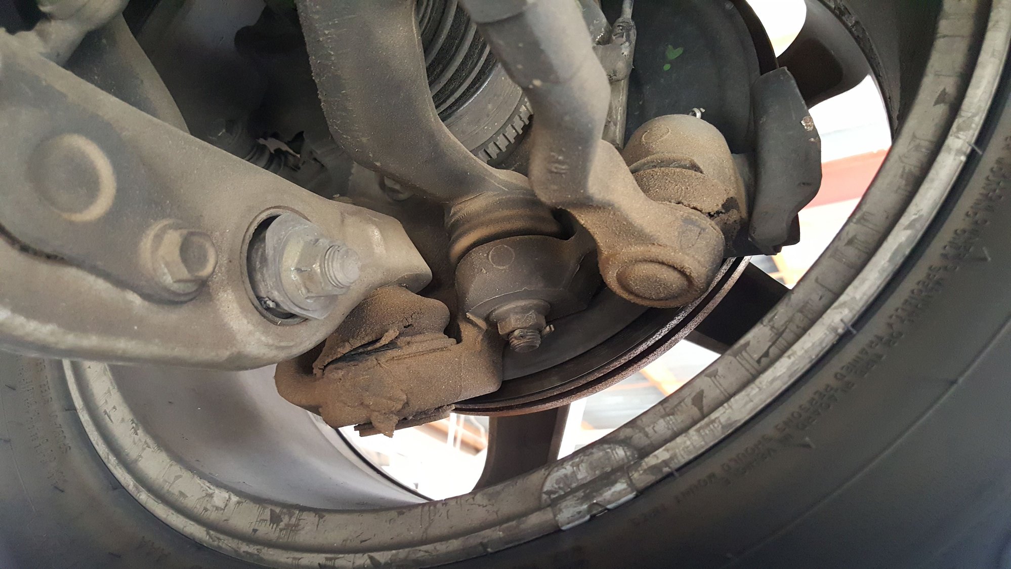

I purchased a 2005 G35X from a dealer cash. They were clearing out some older inventory and they give me an heck of a deal,but the car needs some work.
Car is clean inside n out. Engine, interior were all almost flawless.
I took it to Infiniti yesterday for a recall issue with the air bags.
They also told me the front lower ball joints are worn,
shock absorbers in the rear are leaking, tires are 6 years old and rear rotors/brake pads
need to be resurfaced and replaced.
The price they charged me was pretty much what I paid for the vehicle.
I've read the "before you start a thread section" before posting this so I couldn't find any info about ball joints and shock absorbers.
I found ball joints at Z1 Performance for 71 are those any good and close to OEM quality as possible?
I also found KYB Shock absorbers for 29 a piece at Rock auto can anyone shed some light on how good they are as well?
Is there a write up or video on how to install these things to my vehicle? I had a 300zx twin turbo before and is300, was able to do my own work with those,but I heard these g35 are very sensitive. ive heard horror stories people having trouble with their intake as simple as cleaning their TB butterfly valves.

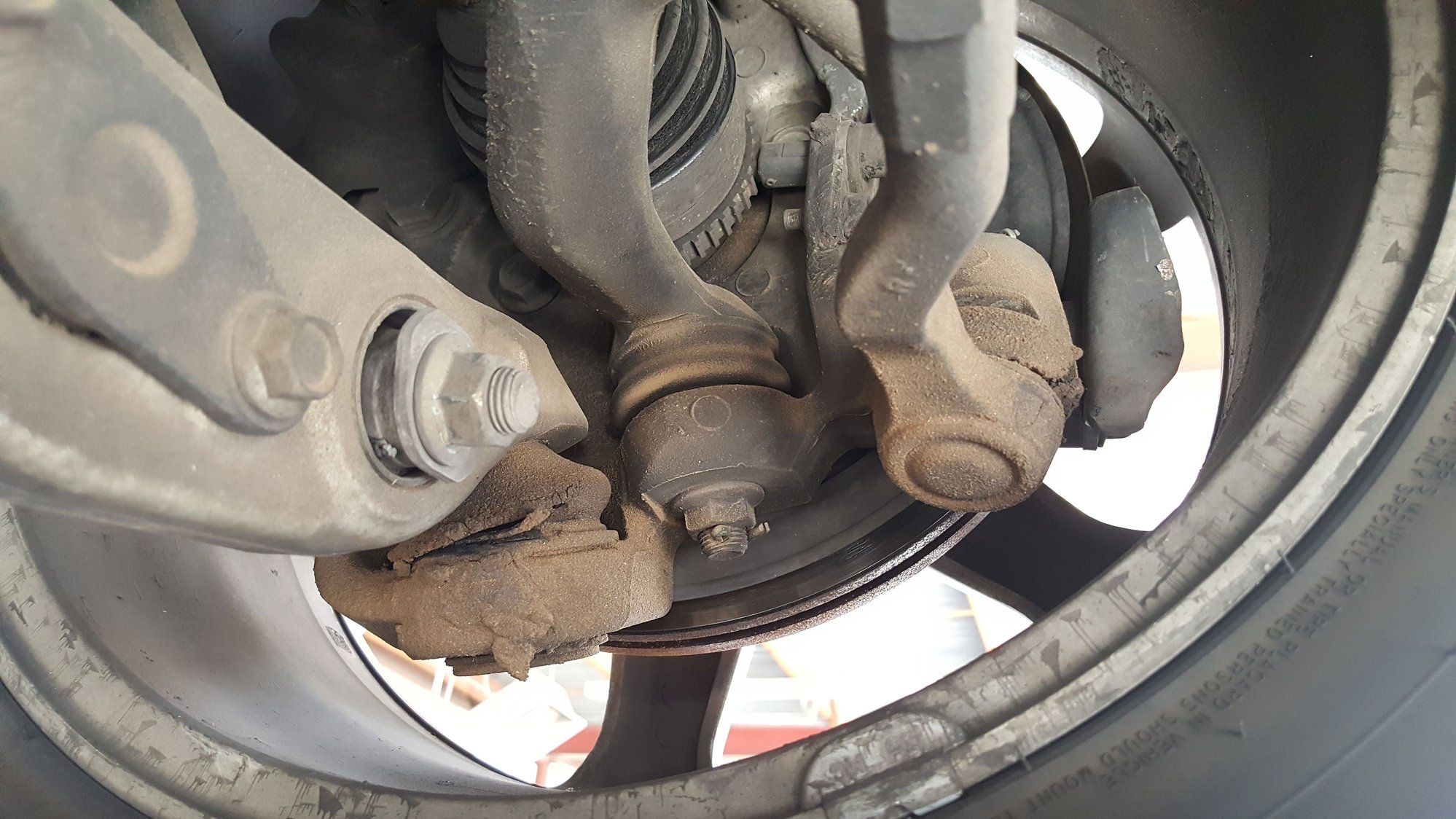

I want it 100% stock even though the car came with a 2nd gen Stillen exhaust lol. But heres some pics of my ball joints when I was doing my oil change left wheel and right wheel.

Your tie rod end boots are shot too. You might as well plan on replacing the tie rods at the same time as the ball joints.

Yeah looks like you need outer tie rods too. If your doing the outer, you might as well do the inner. I did mine using the Moog inner and outer tie rods. I think for both sides I paid like $70 at Rockauto. This also means you will need an alignment afterwards since these are used to adjust alignment. As a matter of fact, anytimr you do any major suspension and steering work, it's always a good rule to perform a 4 wheel alignment.
The suspension on these cars are just crap. The best way to remedy it all at once is jhst to replace all the rubber bushings with poly.
Also KYB makes good shocks and struts. The problem though is that they make the car have a stiffer ride and not in a nice sportier way. For comfort when dealing with shocks I would stick with OEM

Those tie rod boots are ripped. Only a matter of time before the grease inside begins to dry out and water gets in and corrosion sets in. I'd add them to the list of eventual things to fix.
Those balljoints are toast.
I'd snap a picture of the inner bushings where the lower control arms bolt to the chassis. These are a common failure as well.
