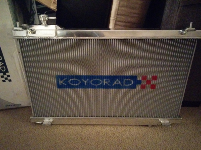

ScraggleRock's Avatar
Joined: Dec 2013
Posts: 6,811
Likes: 738
Get one of these
Oohhhh aaahhhh, shiny..
