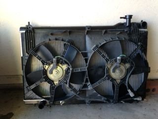

fans hanging on CSF 2983
Originally Posted by jamisxc
I was originally looking at getting the Denso part# 221-3421. But there are several threads in this forum, stating that Denso did not fit.
https://g35driver.com/forums/g35-sed...-04-sedan.html
This will be my first time changing out a radiator by myself. Hence, I'm looking at getting an exact fit replacement. I checked the MFG date on my car and it was built in June 2003 for a 2004 AT sedan model. If anyone out there can provide the brand/part# info, it would be much appreciated.
Taget350z, thx for posting, if you don't mind, after you have installed yours, can you provide some feedback?
Feed back:
My first concern was the figment of fans: They actually did fit. The radiator fit.
However, the spaces for the condenser on the radiator did not fit too well. Also the bolts That connect the radiator to the condenser fan do not even match up. This was CSF 2983.
I found it difficult to attach the radiator to condenser ( this was still connected). Now I've done this probably 10 times before on other vehicles.
Verdict: surprised the fans fit. Disappointed about the condenser fitting. As for it being a direct fit, I'd say radiator fit, but in the end you get what you pay for.

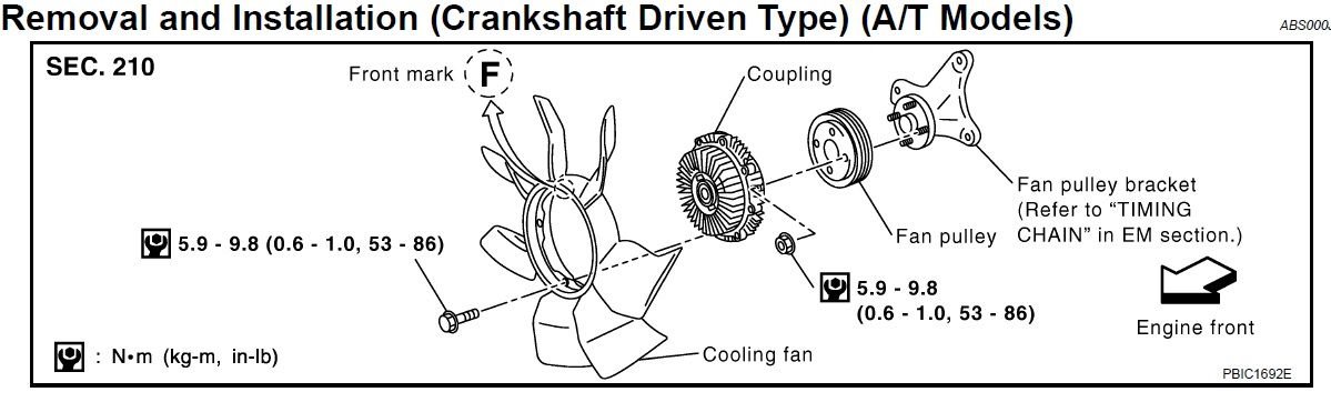

Thanks, I have replace the coolant 3 or 4 times before and removing all the air pockets is no easy task like you said. More questions: Does the fan need to be removed to take out the radiator? I'm assuming I need to remove the steering wheel belt (big belt) first before removing the fan? Also, I searched and someone posted it is easier to remove the radiator from underneath/bottom (easier) rather than pulling it out from top? thx!
Old Oct 30, 2016 | 09:25 PM
si_driver's Avatar
Posts: 206
Likes: 25
From: Baltimore
fan
It's been a while. I am pretty sure that I have removed the fan, but don't remember removing any belts and didn't have any problem removing the radiator from the top.
