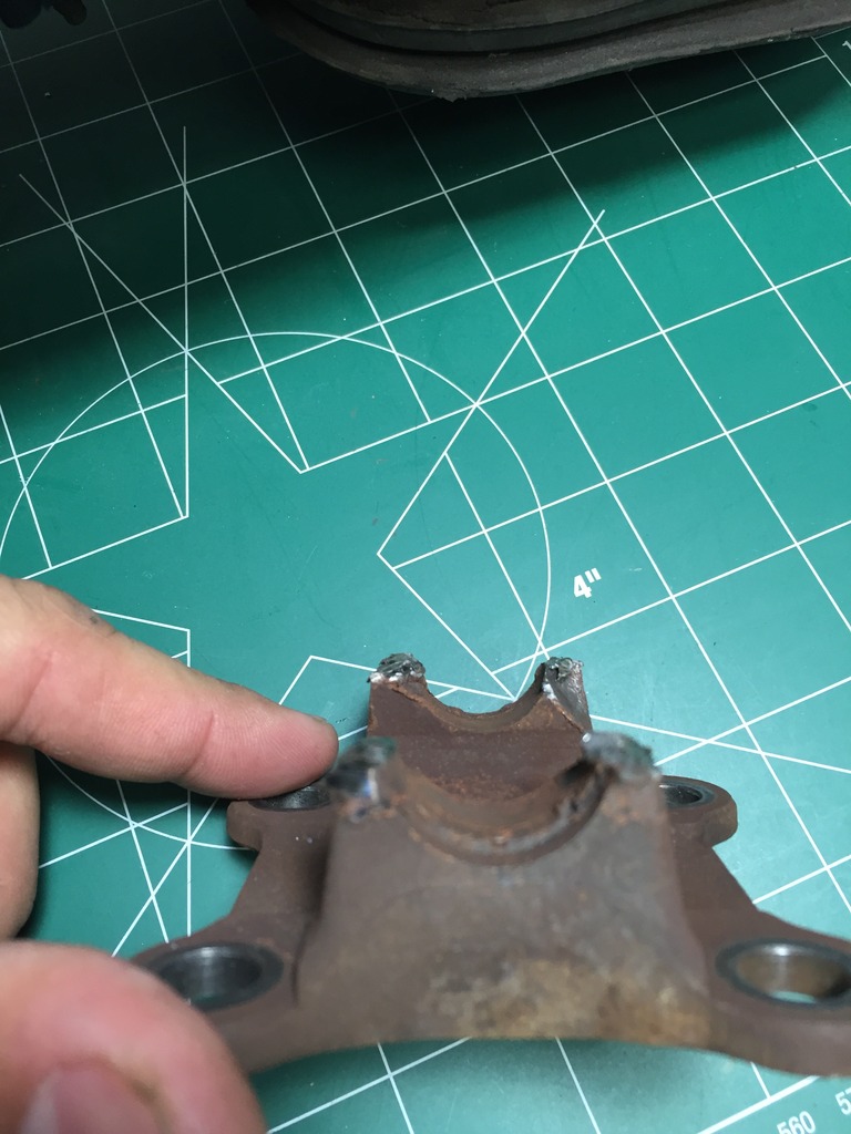

Hard to see in the video where the play in your driveshaft is, but this is where mine failed.
Attachment 178906
Attachment 178907
Unfortunately, I didn't get to inspect it before it snapped off at 80MPH, but when it did, it damaged the differential and transmission bellhousing on the way out.
Attachment 178906
Attachment 178907
