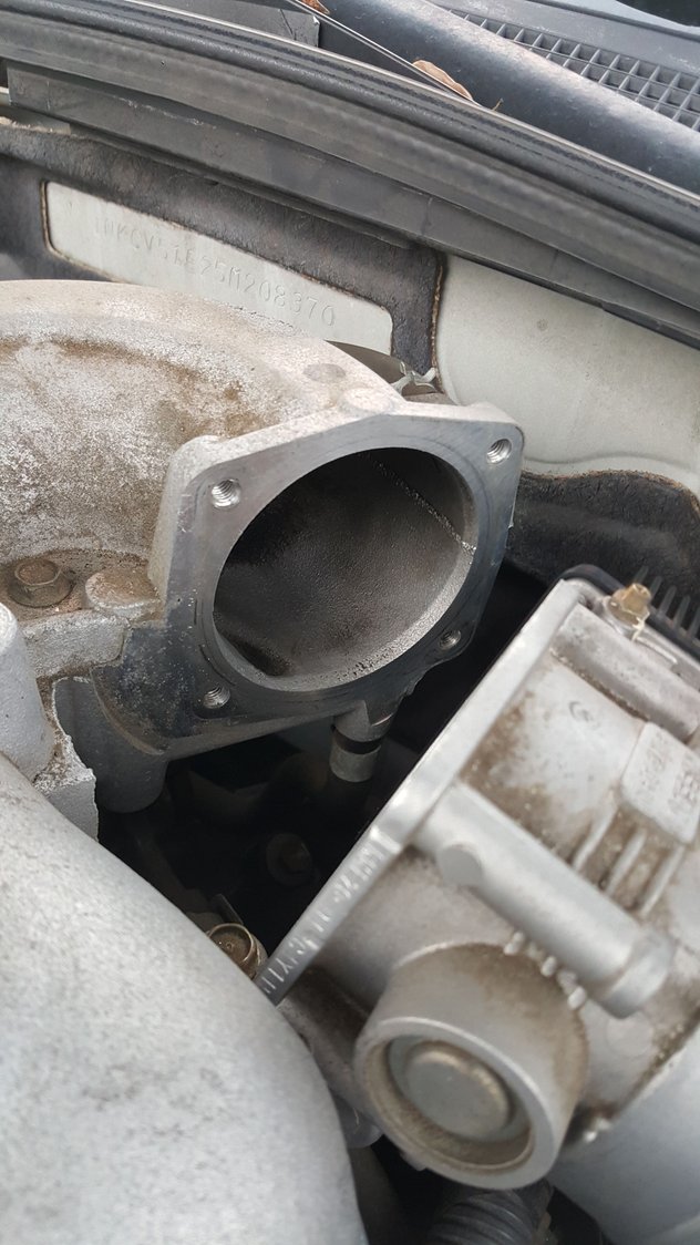

Old Jan 13, 2018 | 07:10 PM
ITSATRAP !'s Avatar
Joined: Jan 2018
Posts: 10
Clean enough
