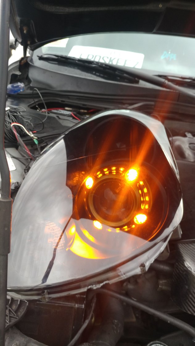

Ebay headlights are crap for these cars.... They'll break and you'll have to spend time taking the bumper off and troubleshooting connections, etc, or buy new headlight after a year or two. Search: "HID Retrofit". Some people have done it, it seems like a good way of getting a decently performing quality xenon setup for about $300 in parts (used headlights, TRS ACME projectors, plus paint, angel eyes, whatever else custom you want).
This is coming from somebody who has ebay headlights on his car, the housing developed micro cracks (crazing) over time no amount of sanding can remove, low beam HID light output is terrible (bordering on unsafe on rainy/snowy nights) even after proper adjustment, both tabs broke on their own somehow, and they go through cheap ballasts like its a consumable. Do it right, do it once.

Best of luck, because it wasn't designed for HID you can't put in HID and have good output. Stick to Halogen.
