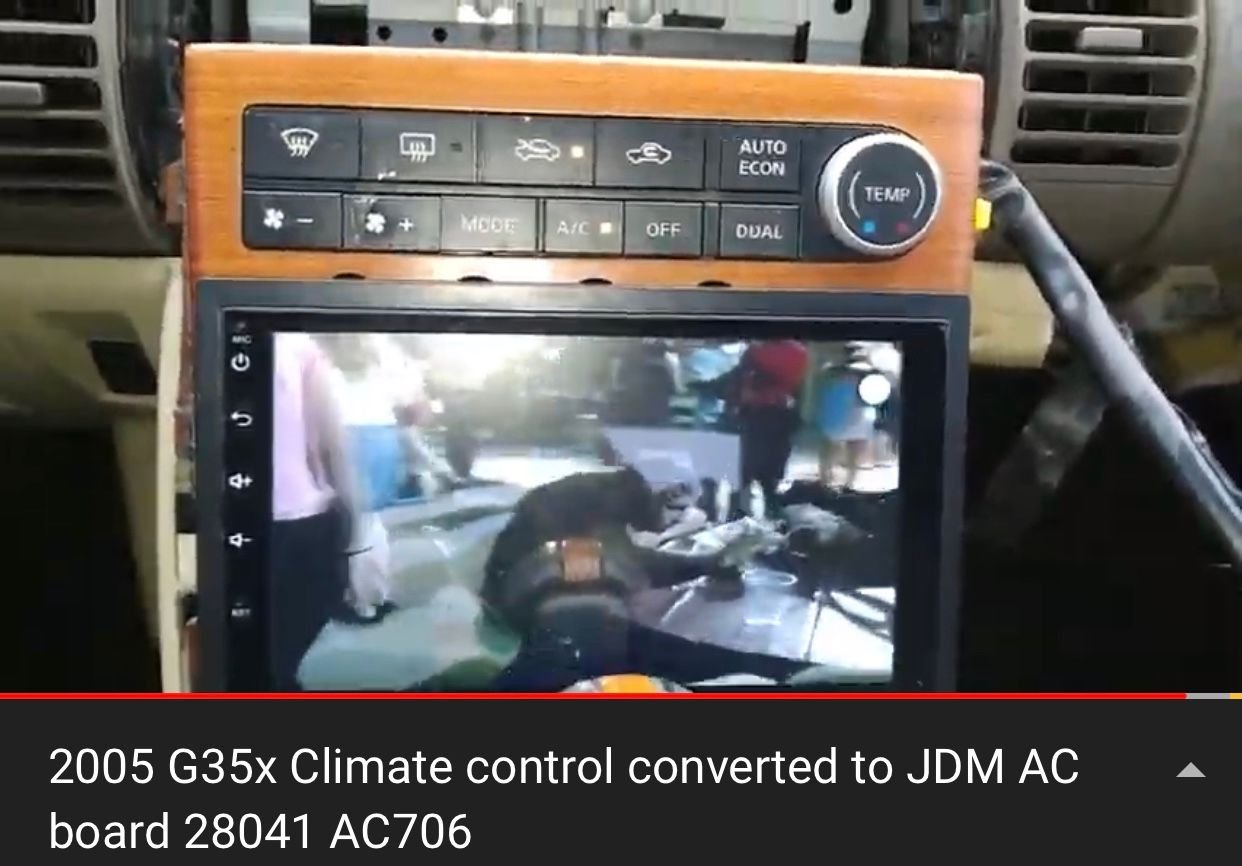

Just kidding. I was going to make a write up "How to" but it got a little too in depth with over 4 revisions of boards and exactly where the boards had to be severed. It also required building a separate power supply on top of things. I really didn't have time to describe in detail where anybody could perform this on all revisions and stopped after building 4 of them. Honestly it's easier buying a used aftermarket setup than spending 8 hours cutting and wiring something like this up. In the beginning I really thought it would be easier. I really should have just started from scratch and built an Arduino based AC control board, it would have been easier.

Do you have the wiring diagram for the 05 climate control because i got a few radio bezels from the junkyard i can work on and test onOriginally Posted by scumbagsleeper

The AC control board wiring is in the FSM. As for a diagram I couldn't find one.
