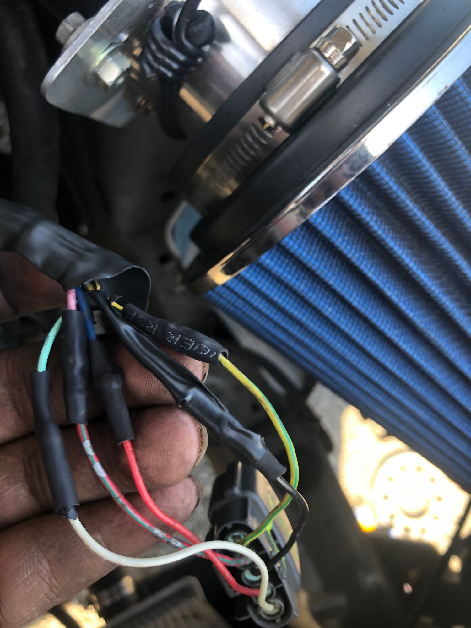

hey sorry for the late reply, i just got done doing some maintenance done and i noticed i got a notification for this
wire harness from g35
blue/ yellow-green / pink / black-yellow /light-green
red / yellow-green / red-green / black / white
03 vq altima/maxima plug *cheap route*
(i got 2 plugs one of each they are the same wire colors)
hope this make sense, and hope it fixes and its the answer you looking for.
“OHG35SY” is the nickname for now . . .
Picture I took after i fixed the wires ( soldered and wrapped) Excuse the dirty hands

I cant really see the other two wire colors
Originally Posted by Javier Cruz
What were the wires colors that you ended up using to connect to the harness?
what are the last to color wires I can’t see it
Look above the pictures and he wrote down all the colors for the wires.
