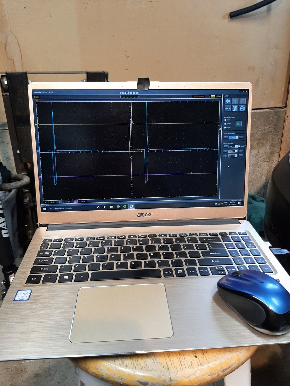

So in case anyone stumbles upon this thread in the future I want to show all the rest of the testing I did and how I finally fixed the problem.
I took the valve cover off and measured the cam spacing against the followers with a feeler gauge. All on bank 1 was within spec.
At this point I was really scratching my head. So I pulled the intake manifold off again to test the injector plug again. 12v coming in and 0.1 ohms of resistance to terminal 22 (or 23? cant remember) on the ECU. After asking a buddy to let me borrow his oscilloscope (3 weeks ago, of course he was out of town so i couldnt get to it) I pushed some needles into the back of the injector 3 pigtail and snaked the oscilloscope cables out. I also took the chance to hook up cylinder 1 and 2 soI could see an injector firing on both banks. After putting it all back together and firing it up I could finally see the dead line of refusal to fire. The ECU just wouldnt ground the injector. (yellow is cylinder 1, blue 2, pink 3)
So I hopped on ebay and found a used ecu for 150$ and got it shipped here. I used the Nissan datascan software and this website: http://keytechtools.com/bcmcodes/index.php to get my key pin code from the BCM. Ran the key reprogramming tool and viola, works great now. I did a power balance test and sure enough that cylinder 3 is helping the cause now.
As far as i know ECU single transistor failure is incredibly rare, but now i can say ive seen it happen myself. If you are running into a similar issue with your car do all the necessary steps to rule out anything else before jumping to a failed ECU. But, like in my case, it is possible.
