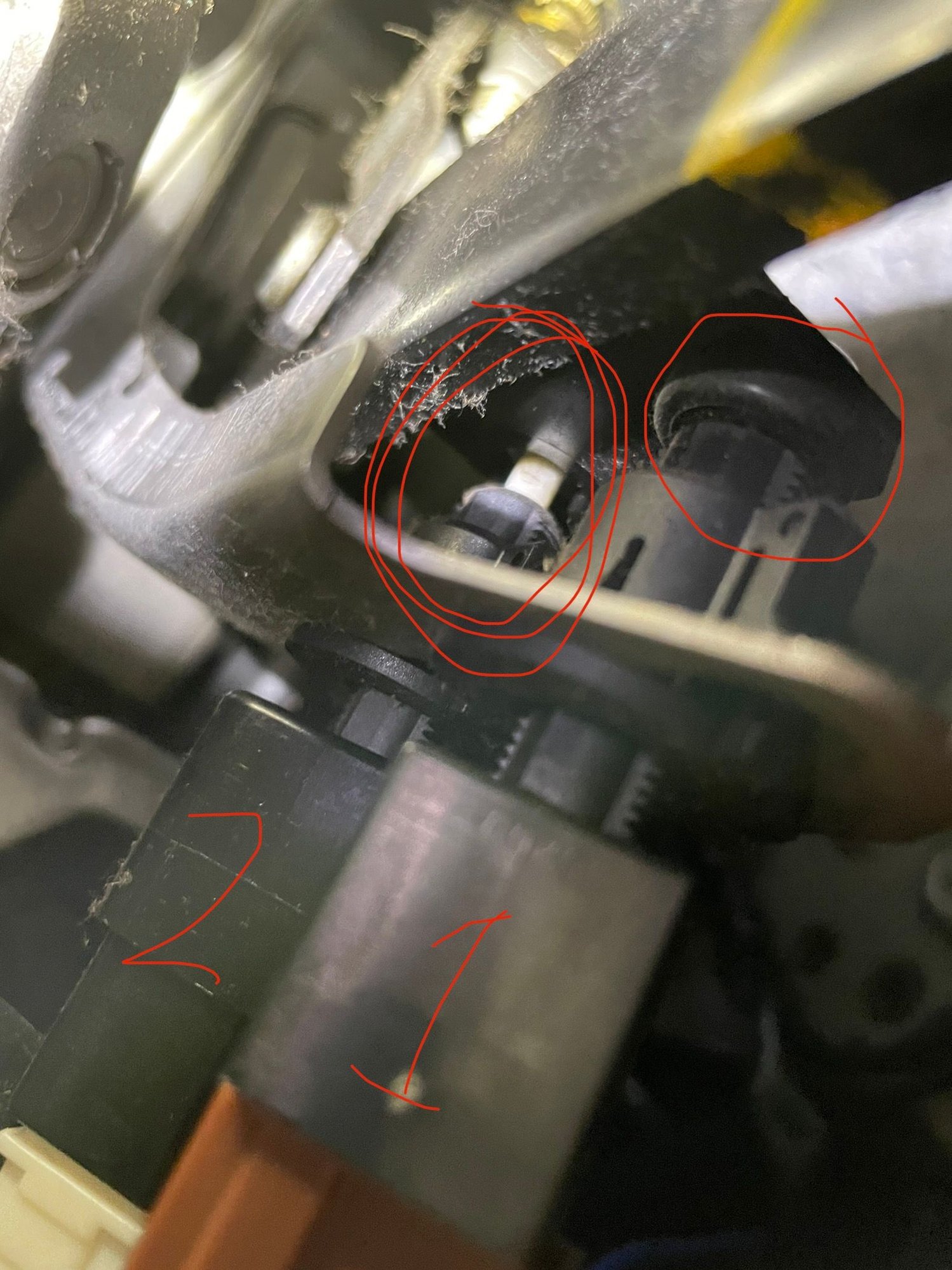

I checked the switch and it appears to be fine. If you know the pinout I could ring it and see if it’s switching or whatever. Any other suggestions if the switch is fine? Could one tire having low pressure cause the issue?? I have aftermarket tire sensors so I know one is a little low.

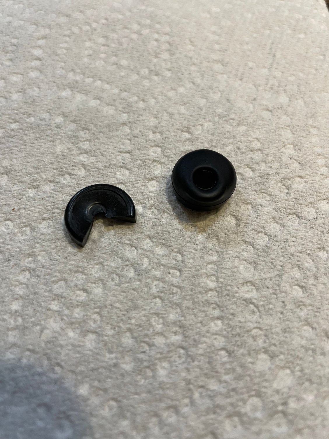

After a MUCH closer inspection, I realized that there were TWO switches for the brake pedal, a second one higher up then I originally saw. The switch was fine, but the small plastic insert that goes into the arm of the pedal had broken off and so the switch no longer had anything to push on. I stuck a plastic body panel clip into the hole (even though it’s too small and still can fall out) and now the brake lights are off! Thanks for pointing me in the right direction!
