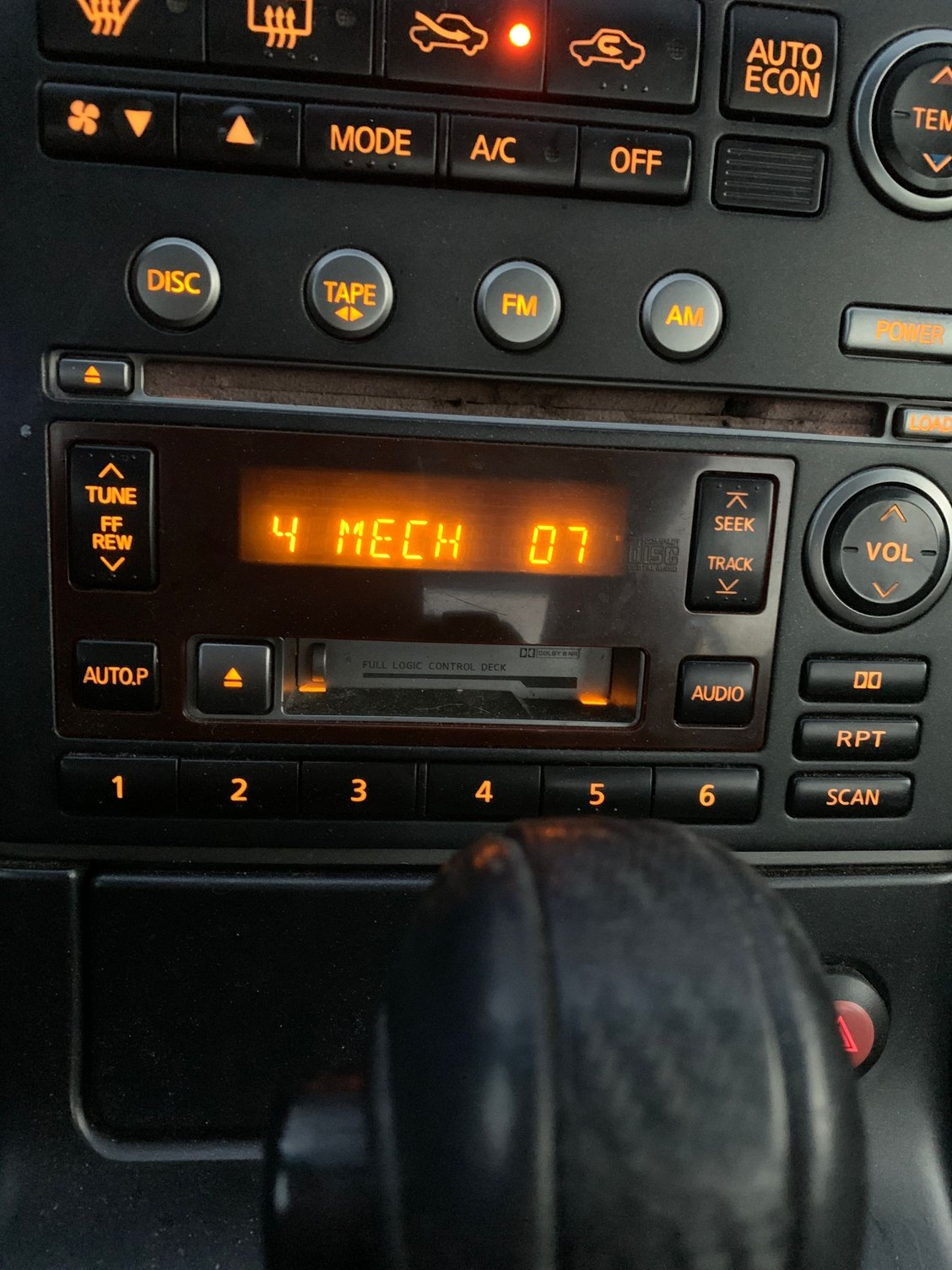

This is what it tells me. Seems that I got 7 mechanical problems with the radio. Tried looking how to replace antenna window but there’s no video about it on a base radio, thank you for helping me I’m a step closer to find what’s wrong with it.
Hmm. It's nice of the manual to show us how to perform a self test but then it doesn't explain what the error codes actually mean. My guess is that a "mechanical" would refer to either the CD or cassette players as they are the only moving parts of the system. Have you got any media in those players? Is there a stuck CD or cassette in either player? Maybe the CD player thinks it has a disc and is taking over your audio? Just a wild guess.
