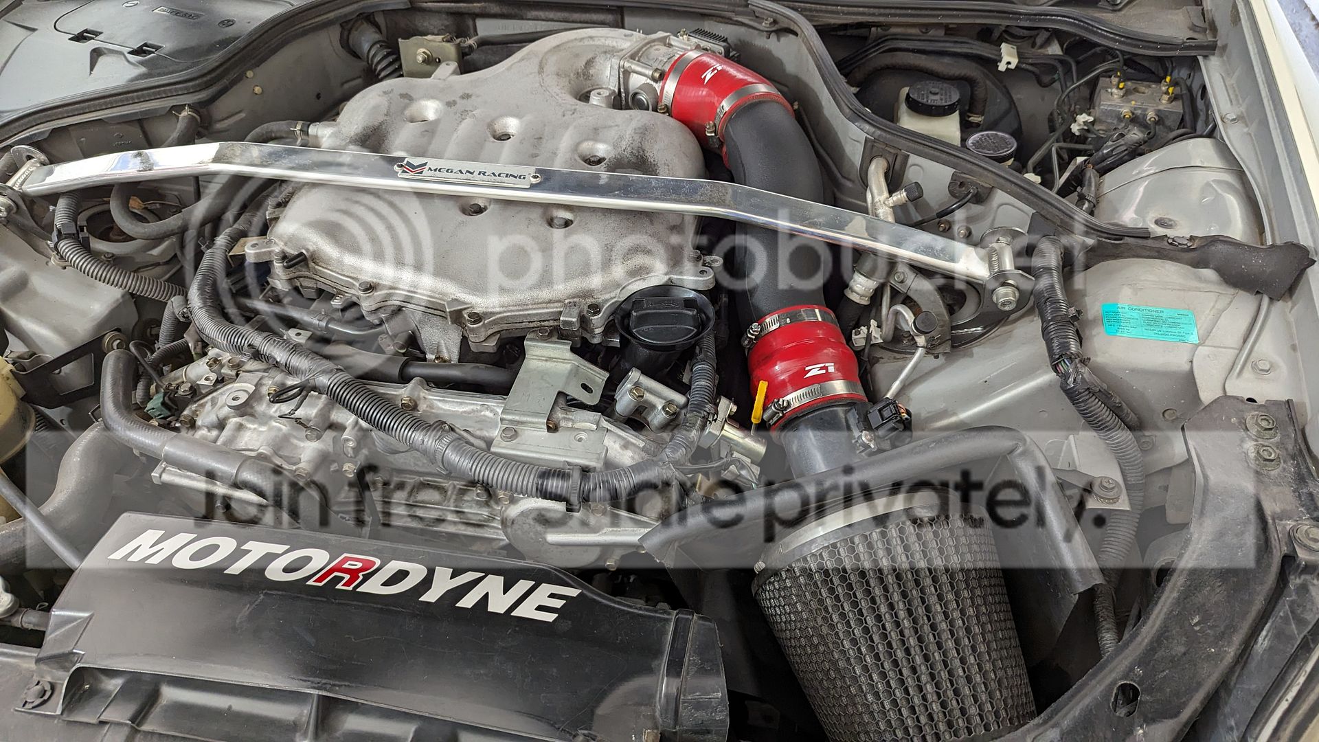

I couldn't resist...
R2C intake I've had for 6 years
New Z-1 intake
First impressions:
1. Quality is very high
2. Definitely need to get the PCV hose they recommend. Which I did. Unfortunately, I wouldn't get the other end of the OEM one loose from the valve cover so had to cut an inch off the original hose to get it to fit better.
3. Since the MAF housing ends up on the other side, be careful you don't twist it the wrong way when installing or it pulls on the wiring harness and twists everything up.
4. Can't hear it over my exhaust (even though it isn't super loud) so if you want one you can hear, this ain't it.
5. Other than the throttle seems more responsive (could be because the pipe diameter seems a touch smaller?), I can't tell a difference power-wise. I'm taking a road trip to Amarillo and back this weekend, maybe the really smooth interior design of the intake may translate into a little better highway mileage.

Thanks for being the guinea pig and for the review! I expect I'll be sticking with my Z-tube and Revup airbox, but will look forward to your update....

Thanks for the review. Personally I'm glad about item #4 on your list.
