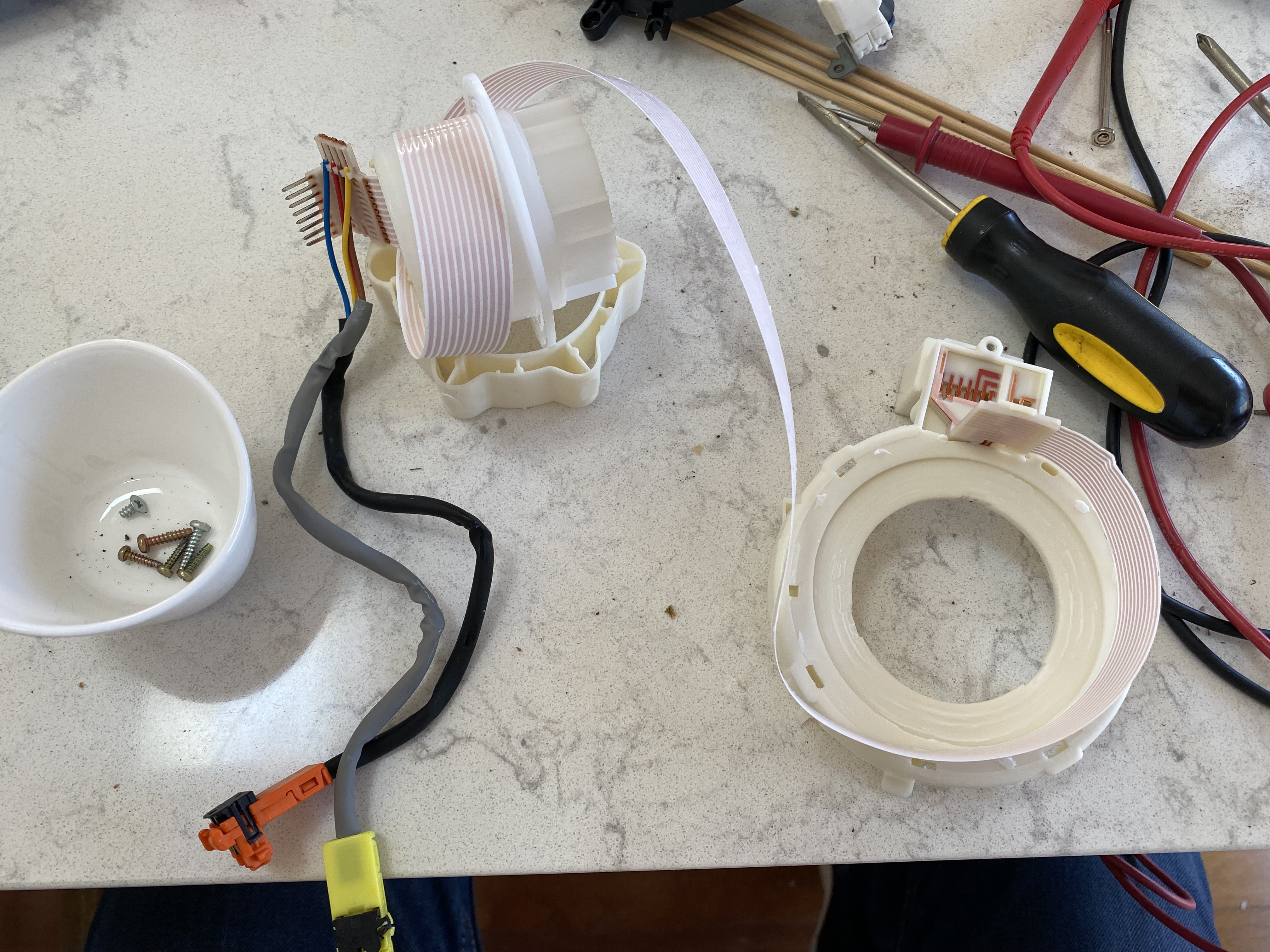

It was the clockspring. I didn't want to drop another 150 bucks on one so I took this one apart to find the fault. It looks like the ribbon cable got pinched during assembly and it eventually caused he ribbon to fail. I shaved away the plastic coating and soldered some strands of copper wire to restore the connection. Reinstalled and cruise control is back up and running. Taking the clockspring apart was fairly easy. Just use some wooden sticks to hold the clips open as you circle around and pry with a screw driver. Once your in there is pretty easy to see where the failure is.
