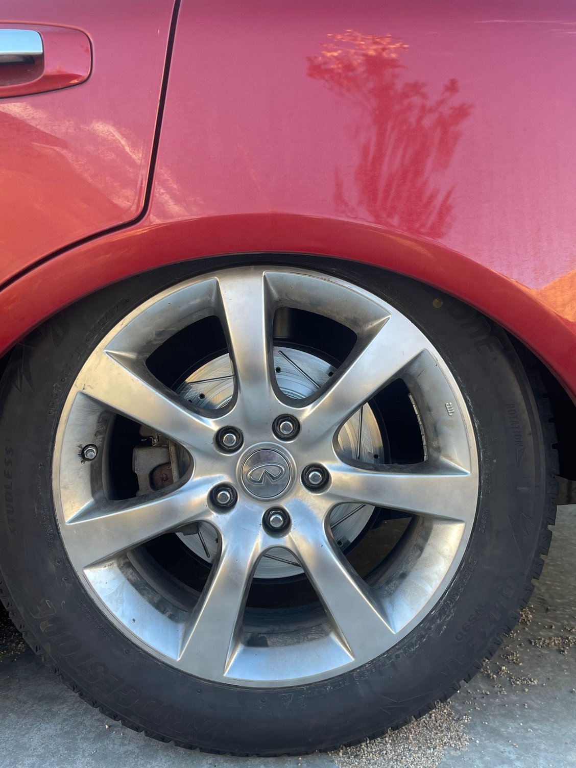

Vibration in gas pedal, and steering wheel under hard acceleration / above 50mph
I’ve been trying to figure out what this vibration is for a while now, it came up after I replaced a really bad rear cv axle. (No boot so it was clicking, possibly hiding this vibration) I’ve had axle bind on my front driver side so I had the axle shortened and it went away completely. I’ve been thinking the rear cv axles are possibly binding because of the awkward angle, I’ve never had that issue before though. I got adjustable camber arms to extend the lca hopefully alleviating the possible bind. I just find it weird that I don’t get any clicking during low speeds or while turning. What do you guys think? (And no I’m not getting a rwd or a new car, the car is special to me because it was my grandmas and I grew up In It so I will figure out the problems and com
e up with solutions.)

Get it up on jackstands and pull on the CV axles to see if there is any play. My suspicion is you have one starting to fail.

Do the same with the drivelines.
