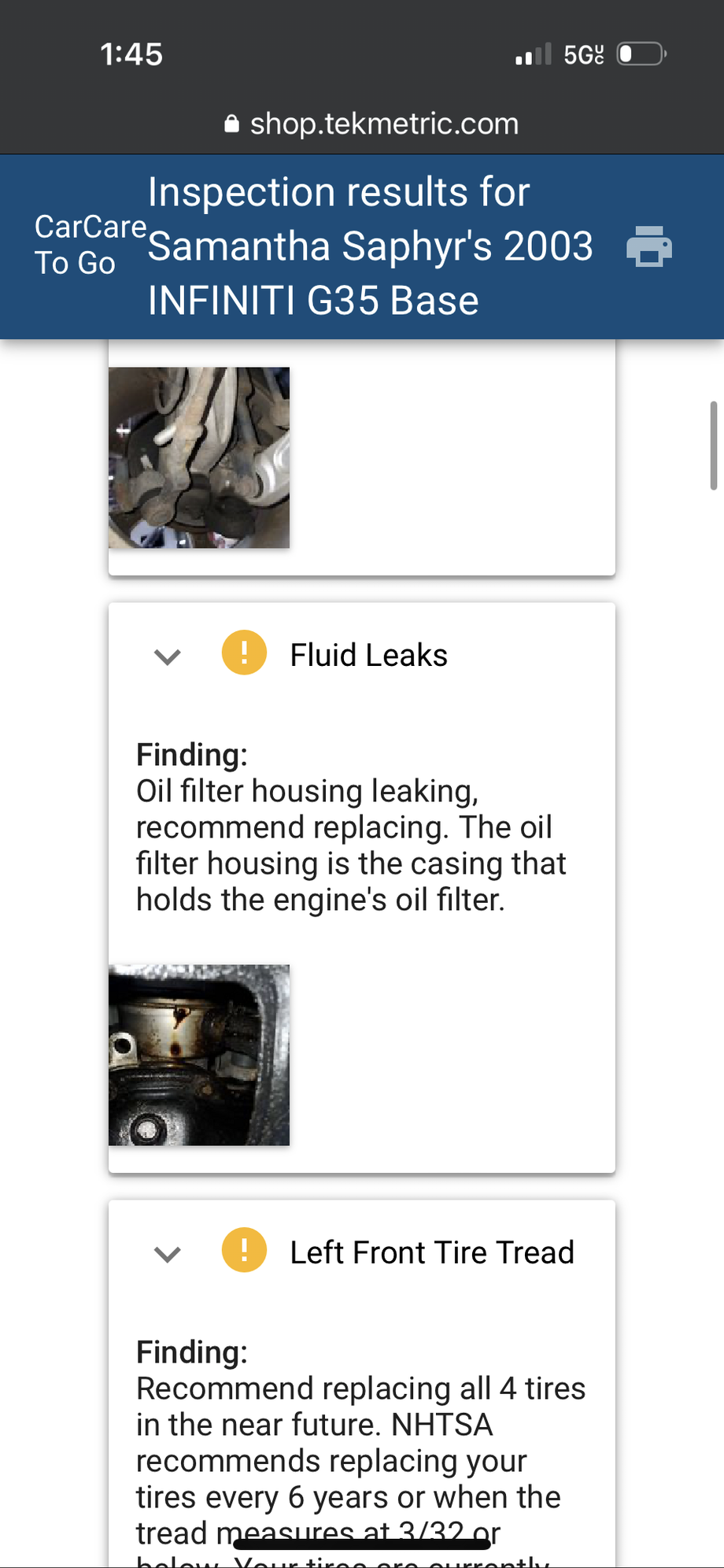

Hey Fam, I recently got my 03 G35 sedan checked out. Among other things, they let me know that my oil filter housing should be replaced since it’s leaking. I’d like to order the parts myself and have someone repair it for me but I’m having trouble finding what I’m looking for. Is it called something else? I’ve seen it called a gasket but I can’t be sure. All I know is that it’s the casing that holds the engines oil filter.
Can anyone let me know what the part(s) is called and/or where I can find it? I appreciate you all!

It's a 10 dollar gasket and you can do it yourself at your next oil change. Don't let them sell you a whole housing. FYI, it's called the oil cooler.

The oil cooler mounting stud (threaded center part that you spin the oil filter on to) torques to 36 ft/lbs.
The o-ring for the DE engine is Nissan part number 21304-JA11A
