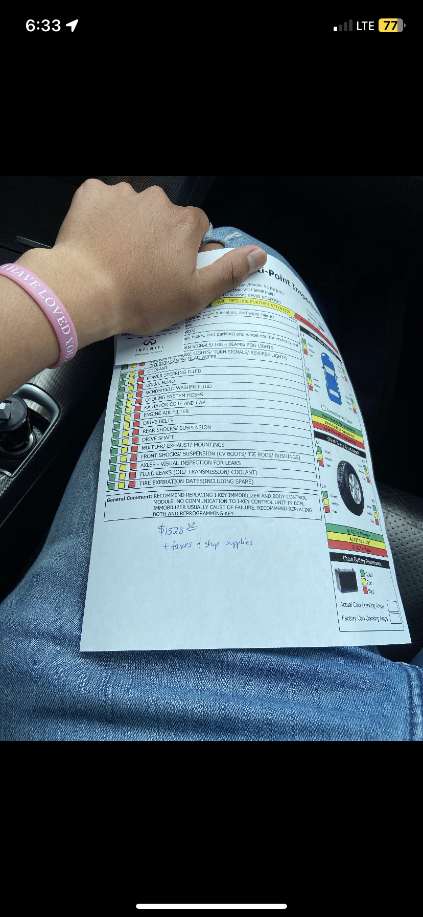

Flash forward to today, they looked over my car after getting it towed there and they suggest me with this pictured:
$1600+ for what they found out; an iKey problem and body control module problem.
What I am trying to gain from this post is whether or not I should continue with the dealership or do it on my own/somewhere cheaper since I now know what the “problem” could be. I am seriously stuck here, especially I don’t wanna spend any more money that I have put in the car just from buying it a couple of months ago. HELP!

Exactly what code is it throwing.

Honestly it sounds like the BCM just forgot the key RFID code which is somewhat common on these cars. If it pulled the immobilizer code then obviously that scanner WAS communicating with the BCM since that's where the code came from, regardless of whether the dealership could or could not connect to it.
First step pull the codes, that points you in 90% the right direction to start troubleshooting.
If the BCM is toast you can source a used one on eBay, just verify it has the exact same MEC number (you'll see the sticker when you look at the BCM).
And find a new dealership to take the car to, $500 for a 1 hour diagnostic should be criminal, it's only $150/hr for Nissan shop rates and that dealership is charging you Lamborghini shop rates...

well the dealership does say it needs a replacement so I might as well buy another BCM either way. They quoted me $200 for diagnostic fee and another 50 for the reprogramming of the key, another 200ish for the part itself and then the rest for supplies, fees, and labor rate :| So should I tow it back home and fix it myself with another BCM and a laptop. I saw a video on YouTube and it seems straight forward

Since you have a 2006 you may or may not be able to access the BCM with Nissan Datascan II. My 2006 6MT coupe I cannot, however other people with 5AT have been able to so I don't know EXACTLY what 2006 cars will work. It's also possible the dealership used the wrong settings on Consult-III which would also not communicate with the BCM...
@seymore4 Does Uprev allow for mating the ECM to the BCM? That might also be an option for you Jackgg
As for whether you should tow it home it would really help to have an itemized breakdown of cost for the repairs at the dealership. If it included the purchase of a NEW BCM then you could whittle that price tag down substantially by just sourcing a used one yourself from an online vendor like eBay or elsewhere. Just make sure you get the exact same BCM, the MEC number needs to match perfectly which is easy to check since there's a big sticker on the front of the thing with all the numbers.
However if the dealership does have their Consult-III tool configured wrong (needs to be talking to BCM on the k-line) then they still wouldn't be able to talk to the replacement BCM. I'd have a discussion with the service manager about that specifically just to ensure they they DID have it set up correctly for the 2006 which uses k-line to talk to the BCM. It's not the same configuration as 2003-2005 or the 2007+ which uses Consult-III. It's a very uncommon communication protocol and since it's been a decade or more since these cars were in the dealership regularly the techs may have forgotten (or never even known) how to do it...
The part that makes me think this is what happened is you previously were able to pull a code which more than likely came from the BCM, that means that it MIGHT be working but just simply lost the key programming.
Something else you could do is pay a locksmith to come to the dealership to try to program the key, just verify that their handheld tool will work for 2006 Nissan/Infiniti intelligent key systems.
