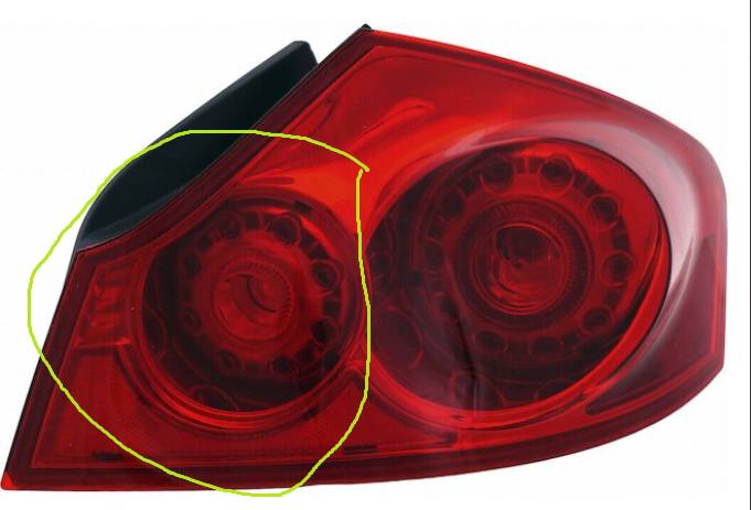

Question Inner Tail light..
I've been researching this for a couple of weeks and finally just pulled the taillight out. The inner tail light, in between the turn signal and the backup light. Is this replaceable? It seems to be an LED from what I can tell but don't know how to get it out, only the drivers side is not working.
Thanks.
